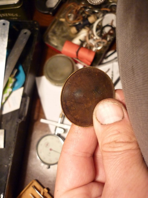

Just to confirm. Zorki with pre 100000 SN are known, it is explained slightly bellow here.
They have round film plate.
http://rangefinder.ru/club/viewtopic.php?f=9&t=13029
Last two comments showing it.
Also, from here:
https://ru.wikipedia.org/wiki/Зоркий_(фотоаппаратура)
До 1954 года применялась сквозная нумерация камер, затем изменённая на погодовую — первые две цифры номера соответствуют последним двум цифрам года.
До 1955 года камеры выпускались со следующим рядом выдержек: 1/20, 1/30, 1/40, 1/60, 1/100, 1/200, 1/500 с и «Z» (ручная). Часть камер, выпущенных в 1948 году, также имела выдержку 1/1000, аналогично модели «ФЭД-С». В 1955 году был изменён ряд нормированных скоростей затвора: 1/25, 1/50, 1/100, 1/250, 1/500 с и «В» (от руки).
Before 1954 sn was the actual count for the each made Zorki. After 54 - two first numbers are year.
Before 1955:
1/20, 1/30, 1/40, 1/60, 1/100, 1/200, 1/500 and Z.
In 1955 and after: 1/25, 1/50, 1/100, 1/250, 1/500 and B.
So, yours is 33795 made from the first one.
I haunted one like yours while been under same illusion what the earlier is the better. Actually, it was worse than other two I previously restored (after 1955), so worse, I'm not even going to write here what I have done with it after I realized why it was sold as LNNU in 2015...

Ko.Fe. & Hughes, thanks for great info and links. Good confirmation of what I had suspected/assumed.
["I haunted one like yours while been under same illusion what the earlier is the better. Actually, it was worse than other two I previously restored (after 1955), so worse, I'm not even going to write here what I have done with it after I realized why it was sold as LNNU in 2015..."] ... Yep, been there on many other projects. However, with my Zorki.3 & Zorki.4, both very early models, they are much smoother and sturdier than newer models I've owned and sold.

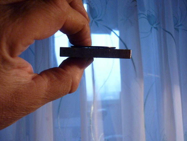

This is the pressure plate, "band aid" shape, from a Zorki, The true round one is only for a Fed camera, according to Fedka, http://jay.fedka.com/index_files/Page455.htm It is the only one I have anyway.

I already mentioned what I have read on rf.ru from person who is fixing and also selling Zorki, FED cameras. I'm waiting for one of his.
Столик от Зоркого с № менее 100 000 совершенно круглый и корпус у таких Зорких без ребер жесткости вообще.
Earlier Zorki (before 100000 sn) has round plate and body is without strength reinforcement ribs.
http://rangefinder.ru/club/download/file.php?id=533&mode=view
http://rangefinder.ru/club/download/file.php?id=534&mode=view

Oleg has worked over both my Leicas and sold me a really smooth 3M. I think I asked him about the round plate several years ago, so it's about time to hit him up again. And maybe DAG.
Thanks guys for all the input and research shared. I've decided to just leave it on the shelf and keep my eyes and ears open from time to time for pressure plate and 20-500 shutter. I found a post today where I had talked about this same camera in 2006. Yeeesh. Too much trouble and expense? Yep, definitely. But some projects are not "Rescue", but rather, "Recovery."
