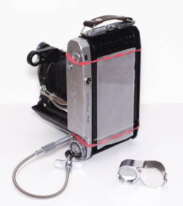

Even better the "cristal" case of a discarded CD is really ideal. Bonus is it's very rigid and break easily. So mark a strong ouline with a blade and snap it to dimensions. Then sand it carefully with the smallest grain you can find.
Then use a powerful loupe to check the focus...
Here is that setup used to calibrate my Moskva 5:
