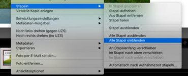

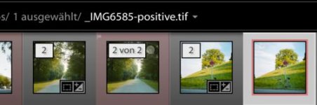

When I select the make TIFF option, and then Apply, I do not see a TIFF. I do see that there are apparently 2 copies (stacked) in LR, but I only can access the NEF (raw) not the TIFF. I have tried unstack etc.
predicolous
Basic user question - hopefully..
Did you try the following?
right klick -> stacks -> show all stacks?
(translated the menu from German, hope it's named that way in the english version)
for me the file "(...)-positive.tiff shows up

In the Library module, if you are still in "Previous Import" catalog on the left-side panel, you will not be able to see the newly created Tiff file... try changing your catalog to "All Photos" or going to the specific folder where your last import was. You should then be able to see the positive tiff file.
I'm trying to see if there is an easier way to do this, because a lot of people edit in the context of the "Preview Import" catalog, and it isn't intuitive to have to switch.
Thank you both, will try that.
