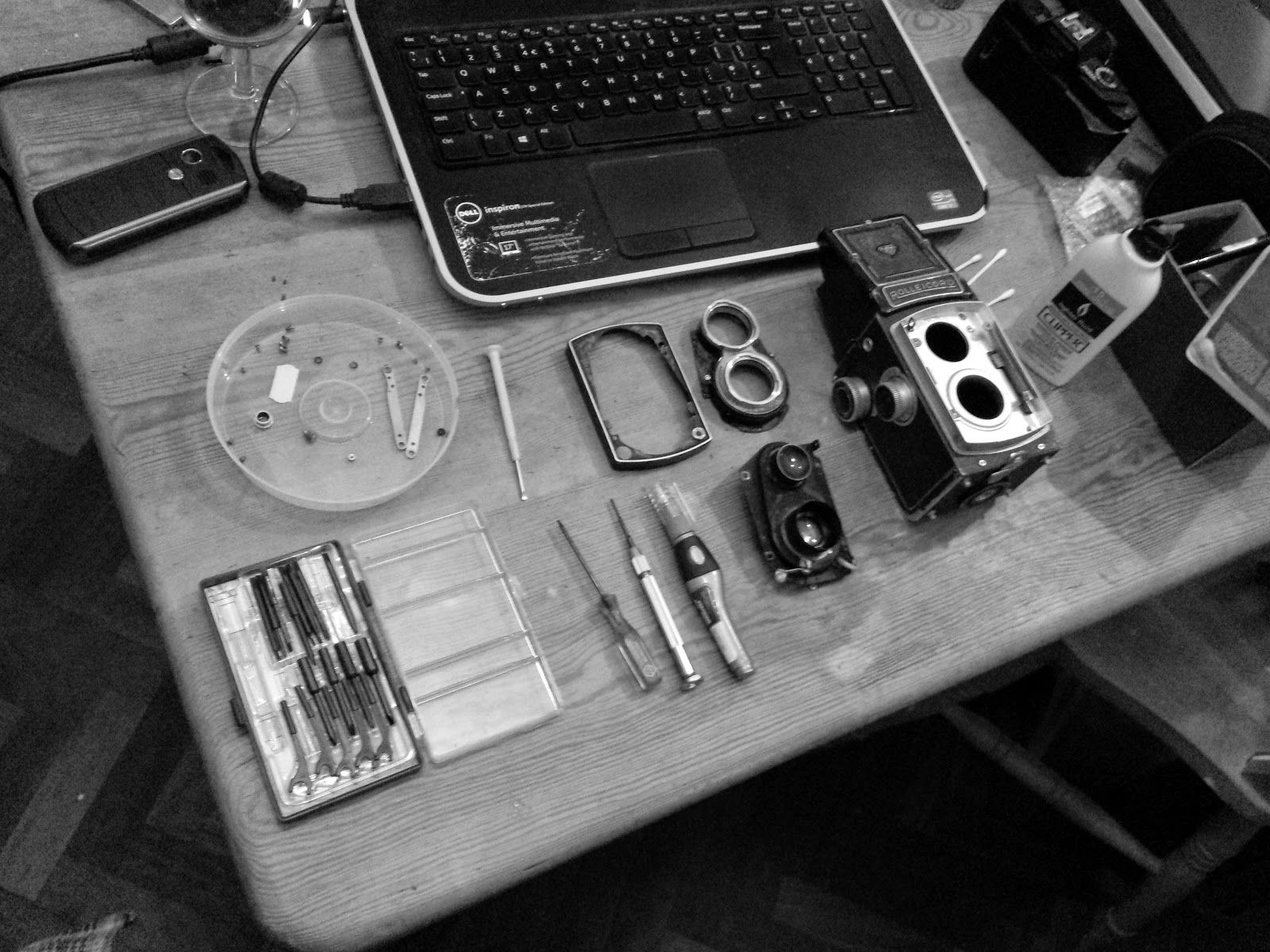

I've been into photgraphy for a while but have recently been given a couple of TLR's on long term loan.
A freind very kindly lent me two of his Grandfather's Medium format TLR cameras.The two are a Czech made 1960's Flexaret Automat and a German made 1950's Rolleiflex. It's been some years since their owner passed and they have been sitting unused in an attic darkroom for a considerable time and while the Flexaret has at some-point sustained a considerable and fairly inexplicable amount of damage the Rolleichord, although very cosmetically ruff, appeared in almost working order. The only non-cosmetic problem which is apparently fairly common in these cameras when they are left stood, is that the shutter is dragging. In this case when set to a one second exposure the shutter stayed open more like three seconds.
Having watched a few youtube videos and read a few posts and having checked with my freind that he didn't mind. Also I have worked as a technician on various cctv equipment for years. I carefully dismantled the camera. I soaked the shutter in lighter fluid several times. A surprising amount of gunk was washed out.Than I flushed the mechanism again. this time with several syringes of isopropanol alcohol which in a matter of minutes evaporates away leaving a dry shutter mechanism.
With the precision oiler I applied a tiny, tiny amount of Low viscosity PTFE based oil to the gears in the timing mechanism and put the shutter back together again.
One second on the shutter now seems to be one second. Result.
Putting the camera back together was surprisingly easy. While it was apart I took the time to thoroughly clean the mirrors and the film transport. It was all fairly pitted with sixty years of grime but it all seems to work. The lenses look like new.
