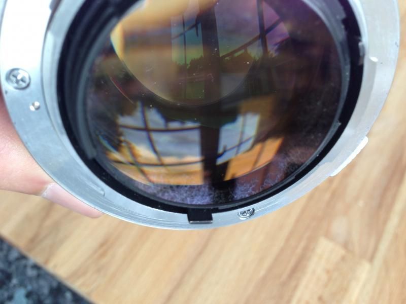

Thanks I might give him a shout to take a look at a BARGAIN lens I've just bought.
...50mm f1.2 for £50!!!
There's some fungus on the rear element but it doesn't look serious so I think a full strip down is in order. Even if I end up spending £300 on it, it'll still be a lot cheaper than the crazy prices in eBay.
