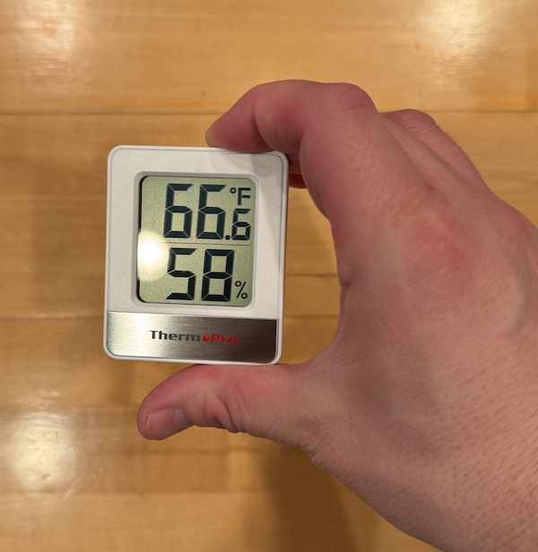

Today my M11 froze, like many other times, requiring the battery to be pulled. That much isn't new. What is new is that the camera was very hot to the touch -- every part of the camera was very hot -- lens, top plate, battery, etc. After several minutes I realized I should document this, see pict...
There's a technical survey posted on L-Camera Forum but I don't know how valid this link is:Today my M11 froze, like many other times, requiring the battery to be pulled. That much isn't new.
After several minutes I realized I should document this, see pictures below. The ambient air temperature was 66F, and at the time of taking the photos (3-4 minutes after pulling the battery), the camera was still in the 90s. It was definitely 40+ degrees above the ambient air temperature when I noticed the issue.
What makes this more odd is that I hadn't taken any photos or even touched the camera when this occurred. I turned it on, expecting to use it at a function, and left it on a table. About 2 hours later, I found it like this. Nobody else had touched the camera, as it was within eyesight the entire time.
What makes this even more odd is that the camera just got back from being serviced for freezing from Leica New Jersey. Leica said they couldn't reproduce any freezing with my body. It freezes every time I use it, and now evidently overheats too.
By the time I do get this resolved, I expect I'll be trading it in for an M12...
