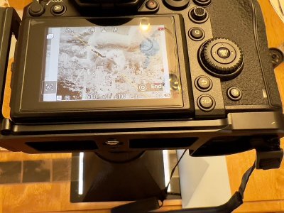

With the original firmware and modified sensor, what does the screen show you when you review photos in camera?
I see the images in monochrome, since my settings for preview are also set to the same.

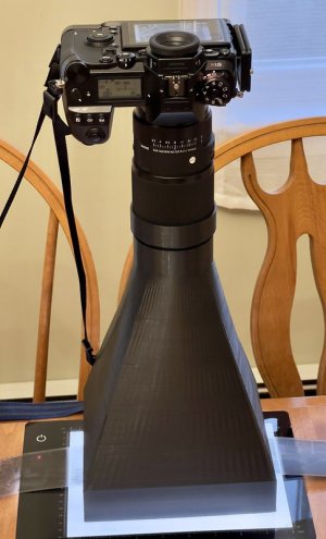

'Scanning' with a camera works very well if you have a good setup and it is dramatically faster than scanning on a flat bed or with a film scanner. Much higher resolution too. The two biggest things are making sure the negative and camera are square to each other and that no external light can get between the two. I 3d printed 35 and 120mm film holders and a lens/camera holder to hold the lens the proper distance away. Takes a minute or two to setup and I can scan an entire roll in a couple of minutes.
This is the 120 setup. Lens is the proper distance so negative height uses the entire height of the sensor. For 6x12,6x17 and 6x24 I just take multiple shots and stitch them together.

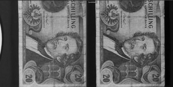

If you measure the improvement in resolution, you get around a third increase at best, but copying negatives is a good example of where you can maximise the output. Tonality is hard to measure, but I got the nicest black and white film ‘scans’ since the Leaf 45 from the M11M with BEOON and a high resolution copy lens.
Your spatial resolution is going to be 36 megapixels. You didn't gain resolution, you got rid of potential artifacts from demosaicing.
Take a shot of something on your mono K1 then take the same shot on a color camera with 2x the megapixels. The high resolution camera is going to have more detail along with potentially some artifacts from demosaicing. You can see this here. Compare the M246 Monochrome vs the S1R (Panny about 2x the resolution of the Monochrom). There is some moire on the Panny image in regular resolution color mode but it still has more detail than the M246 monochrome. Download the RAW files and convert the S1R to B&W and the moire is gone and it clearly is more detailed than the M246 Monochrome. (Monochrom on left, S1R on right)
