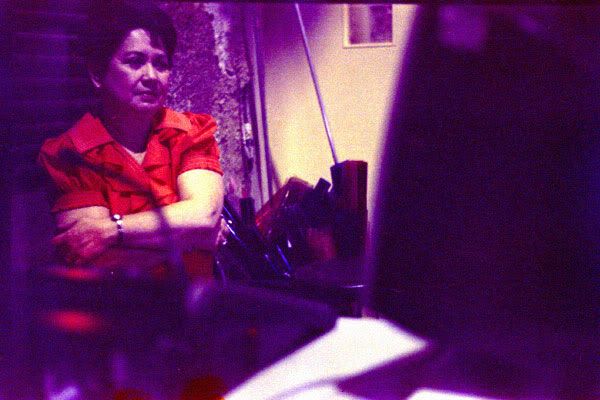

...This is a set of photos I pushed one stop (160VC Portra) and shot rated at 200ASA:
VC 160 which is officially ISO 160 when pushed one stop should be rated at EI 320. 200 "ASA" is barely a 1/3 stop underexposure from the official 160. And that will hardly need a modification in processing - extended development- to make up for the rather slight underexposure.
