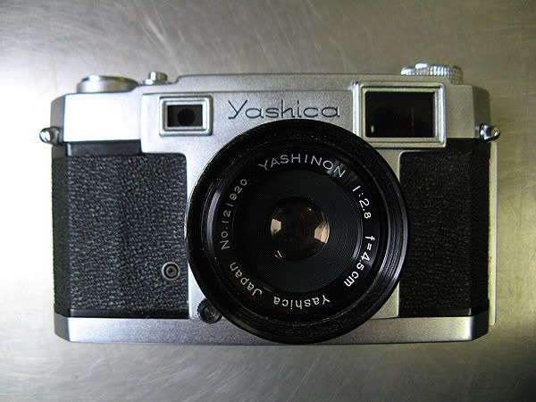

Hi Andrew,
Here's a pic of mine - almost ready for use, just have to re-glue the "leather":
Yours is the same model? The technician is probably right in his assessment, but $200 sounds pretty steep, especially if they're just going to clean the self-timer. The slow speed escapement and the rest of the shutter should be serviced at the same time. I'd get another quote, or alternatively I could service your shutter for a lot less if you're interested (I'm in Brisbane). Send me a private message if you want to talk about it.
