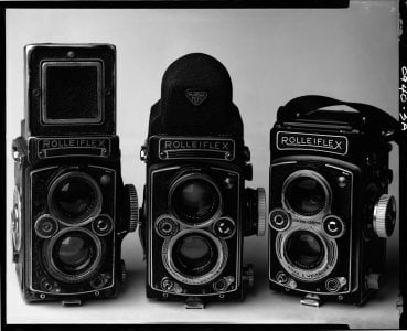

View attachment 4846711Rolleiflex 3.5E3, 6 element Planar, in my unbiased opinion the best Rollei ever.
I cut down an RB67 screen, so much better than the stock screen.
One of my 'never sell' cameras.

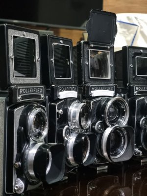

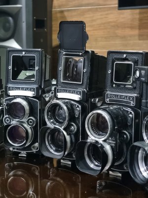

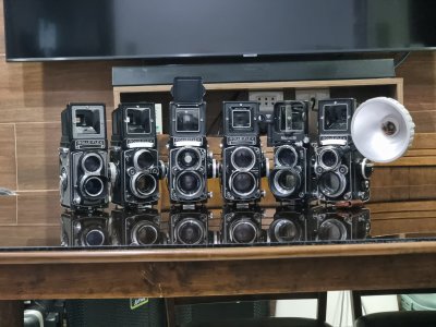

Here are some of my TLRs. I do have to say I may have been married to a brand - beats me!; and yes, I do use them, dearly with love and care.
