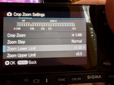

You could always use the fp L with APS-C lenses. It has plenty of resolution (25 megapixels in APS-C crop) and has a more sophisticated crop mode compared to simple FF or APS-C.
I don't have any APS-C lenses to test it but you might be able to get wider than typical if they cover a little more than APS-C and you set a lesser crop. It will even let you set a crop and a different aspect ratio. I've been shooting a lot of 1x1 in the Sigma. Would be very cool if the 10-18 would cover FF 1x1.

I tested your theory just now and on the Fp it is impossible to override the dc crop with aps-c lenses and when you open the image in lightroom you cannot get the full frame back so my 1:1 image was very lo res.

I don't think the fp has the same crop zoom feature as the fp L. It looks like it is possible in the menu (turn off AUTO on the Lower Limit) but want to confirm that.
