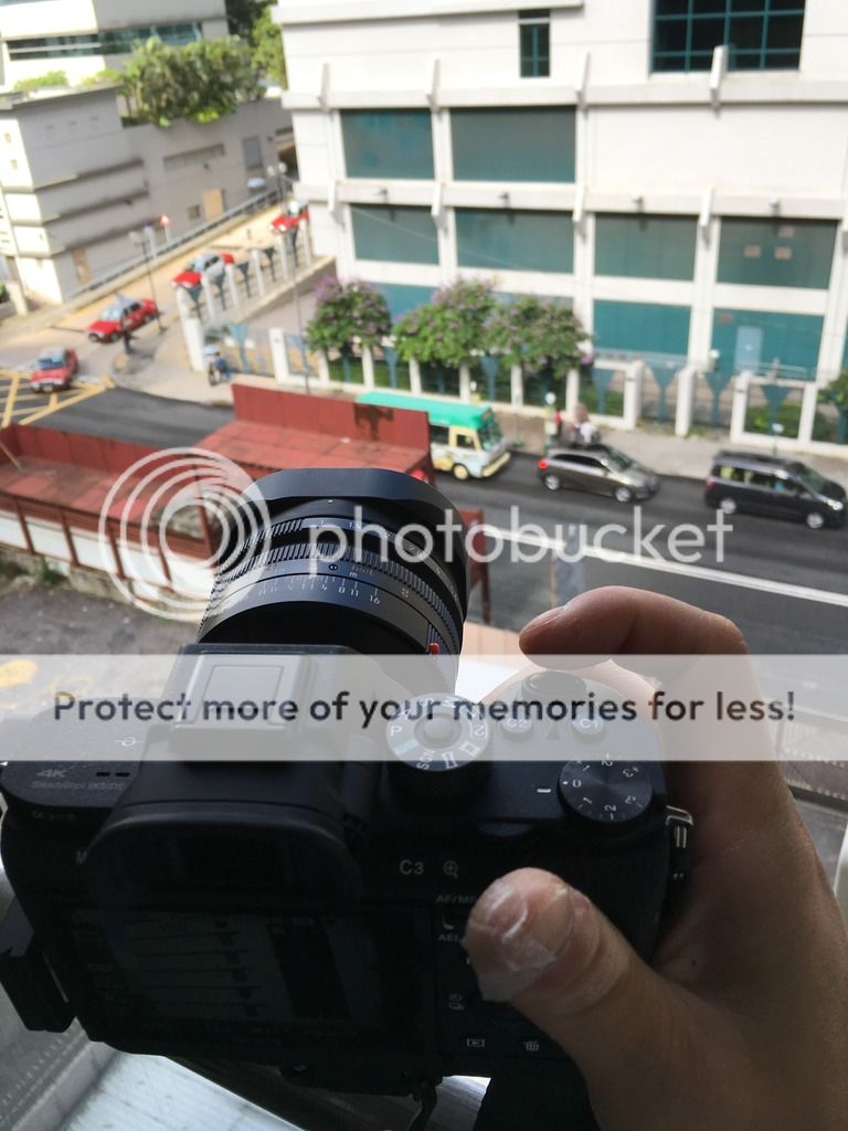

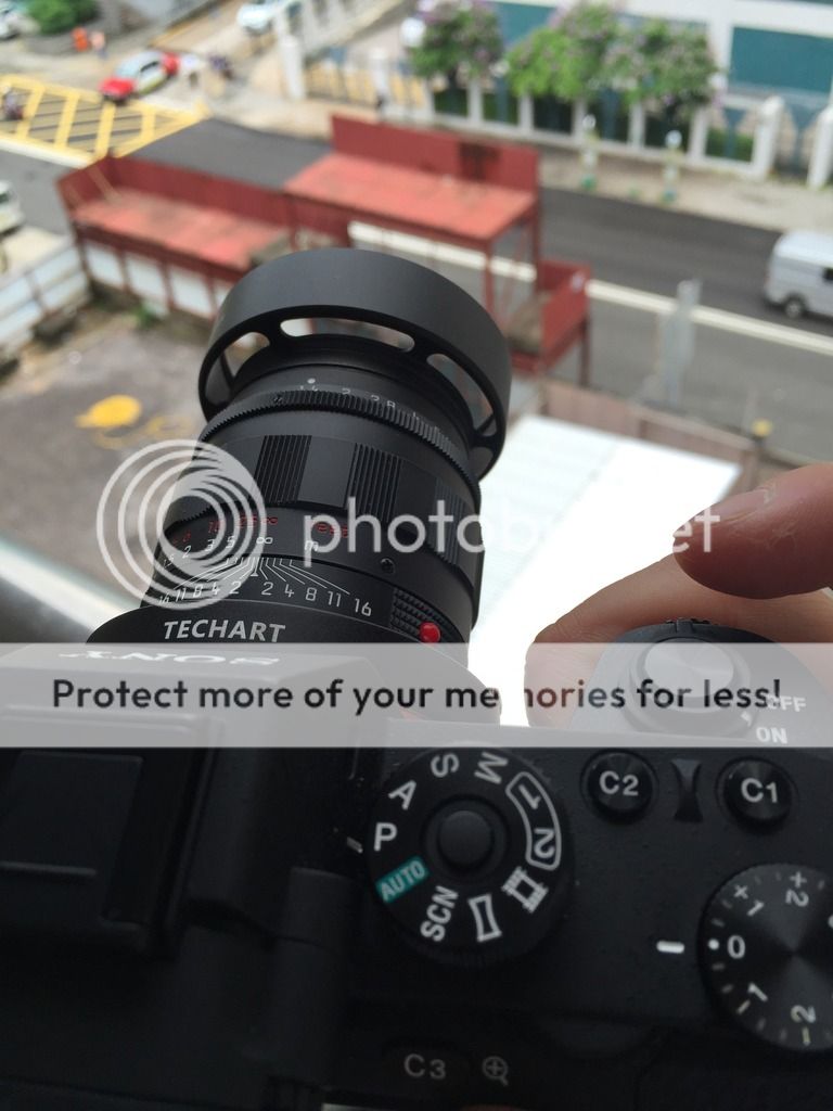

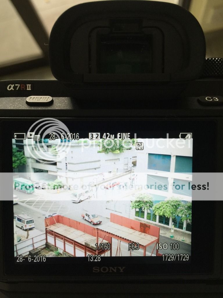

Dear all, I actually received my Techart adaptor in April and I did update the software of the adaptor once it was available, focusing not a problem, but I found with the adaptor, my Sony A7 R2 consistently overexposed (by 2 to 3 stops or sometimes even more) with any Leica lens or Leica mount lens I have under bright sunlight conditions
I love its idea but I really can't cope with the overexposure under bright sunlight

I did get overexposing at first but it went away after turning lens comp off. I think this adapter fools the camera to think that there is a Sony lens attached which in factory settings has rather robust shading correction.

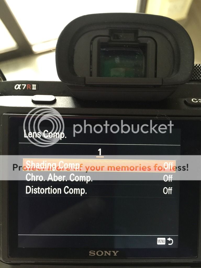

"Lens comp", is it the menu thing with 3 options?
Shade, c aberration, distortion comp
I actually tried turn them off one by one, unfortunately it doesn't help
Is it my early version of Techart adaptor fault? If so, I don't mind buying another new as I love the idea, but I first want to be sure I can use it with my lux lens wide open (as the exposure problem improves a bit with f5.6 or above, but ridiculous to do so)
Thx a lot!!!!
🙂 Very good!
Glad to help!
