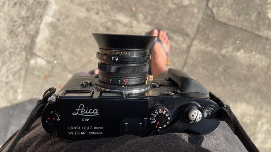

I have two of them, one with the goggles No. 20606XX and the other plain No. 17772XX, I do not know the years of production. It is funny that I can screw the optics from their mounts so that I can use the early one in the goggles and the later one in the plain mount. No problems with focusing.
I think that they are optically not for 100% the same. The later one seems to be a tad sharper at full aperture. But they are both the most beautiful 35's for the M Leicas.
I also have the plastic lens cap (found separately) and a whole collection of OLLUX shades, there are many versions of those.
I've not seen the new one in the flesh. It would be nice if this new one was tested against the old ones.
