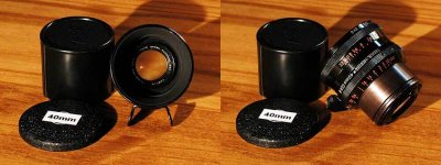

My rarest collectible glass was actually for cinematography (though I always dreamed of converting them to still lenses). It was a complete Taylor Hobson Cooke set of Speed Panchros, Series II & Series III. I put together the set in the early 2000's for about $2500. In 2010 I sold the complete set for $7500 as everyone was looking for vintage glass to use with their digital cinema cameras. I thought I was the luckiest guy around. Now they are worth three to four times that amount. Oh well. They were beautiful lenses.
