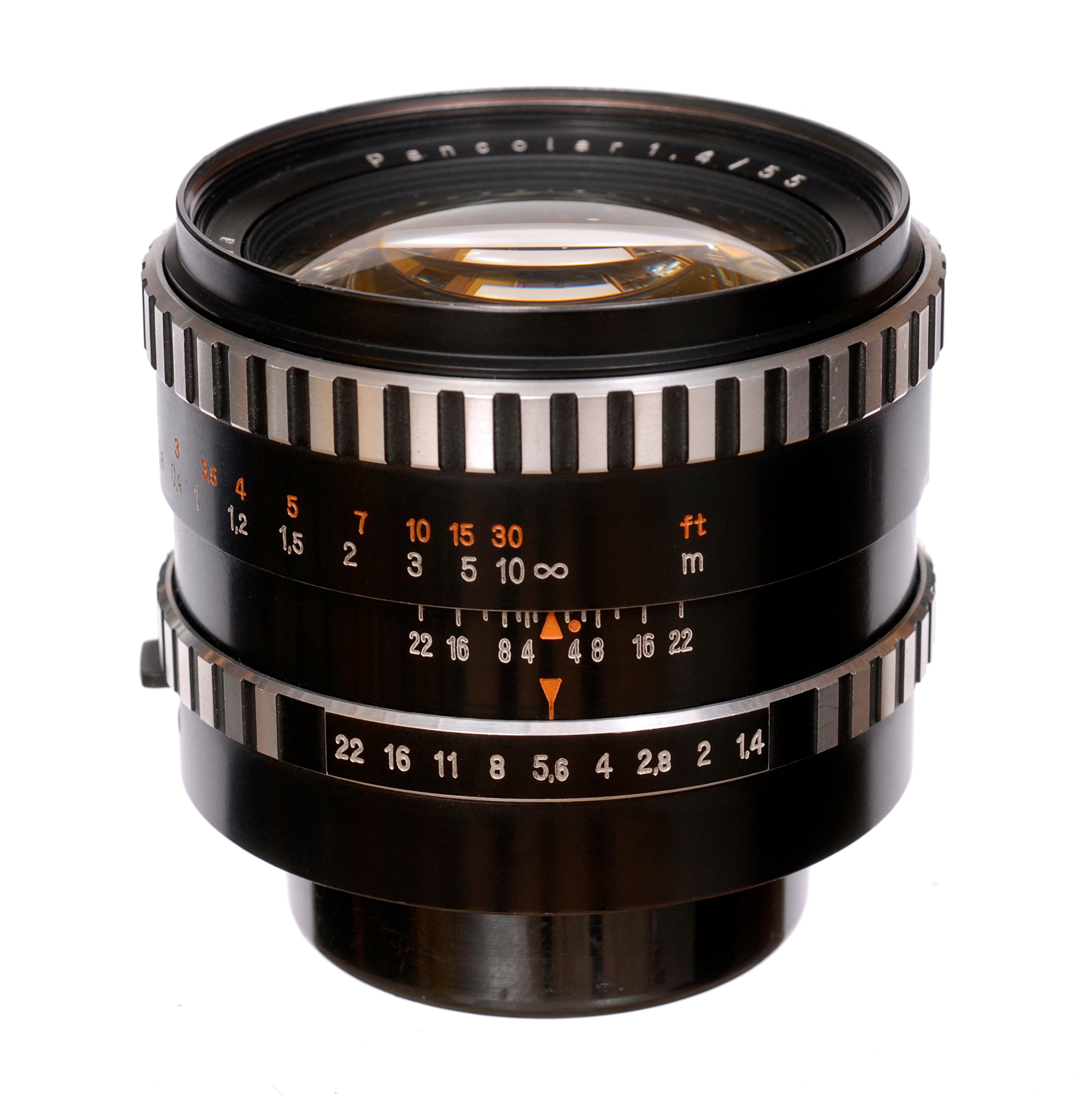

Finally I got this one. Lusted for one a long time now. A Carl Zeiss Jena Pancolar 1,4/55 (M42). This thing is huge and radioactive. 🥳 I'm very interested in comparing it to the later Pancolar 1,4/50 or my Mamiya 1,4/55.
Pancolar 1,4 | zeissikonveb.de
Pancolar 55 mm f/1.4 Pancolar 75 mm f/1.4 Carl Zeiss Jena

Congrats, very cool lens. Show us some photos with it.View attachment 4853416View attachment 4853417
