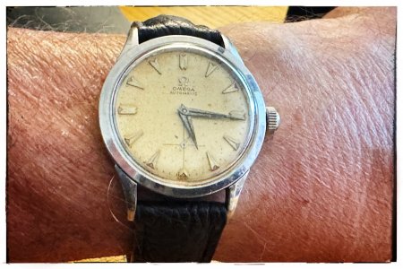

This is the watch I'm wearing today. It's a 1957 Omega Automatic that my friend gave me. It belonged to her uncle, who bought it in 1957 and wore it daily until he passed away about 20 years ago. It had no particular sentimental value to her, she just wanted it to be enjoyed and used by someone who would appreciate it. I had it serviced and fitted a new band, specifically told the watchmaker to "lightly clean the dial and hands but keep the patina intact." It's a lovely watch, keeps pretty good time (about 1 to 2 minutes fast per day, so it could use a little further regulation); I like the fact that it is small and light weight, unlike so many men's watches these days which mostly seem grossly over-sized and over-weight to me.
G
Is that one old enough to have a bumper automatic mech? I forget when Rolex's patent for 360 degree rotating oscillating weight expired, sometime in the late '50s. Before that everyone else had to keep making bumpers.
That watch's patina is at a nice level. I do prefer original finishes with flaws over dials that have been refinished. It would not have left my shop running 1 - 2 minutes fast per day.

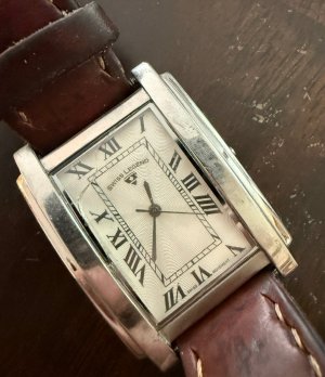

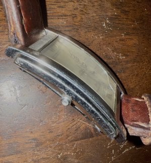

A bit off topic, but here is a different repair that I do not wish to do myself, even if I had the replacement part: it's the overlying glass that cracked when I dropped the watch. It's a curved crystal, so not a flat piece of glass. I can't seem to find who can make or supply a replacement. The watch runs fine, always matches my iPhone time, and it's my favorite with its curved rectangular shape.
GMOG
You can get a blank but it would still need to be sized to fit. Crystal fitters use wet diamond wheels to cut and shape glass. You could duplicate that with a small, fine cut diamond sharpening stone and a fair amount of your time!

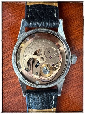

It's a 'spinner' rather than a bumper automatic wind mechanism:
(Lovely movement ... I had to snap a photo of it while he had the back off of it.

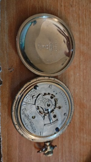

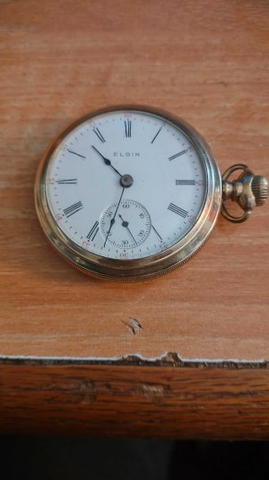

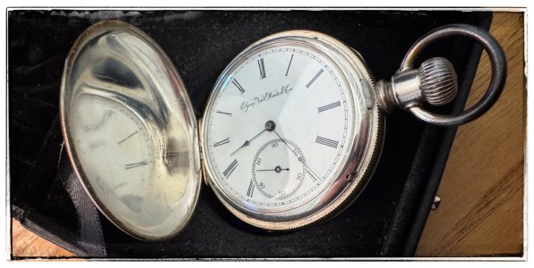

I'm sure it wouldn't have left your hands needing regulation. The 1890 Elgin National pocket watch you restored for me keeps perfect time! (Which reminds me that I should get some silver polish and do the case again ... It's showing a little bit of tarnish.)

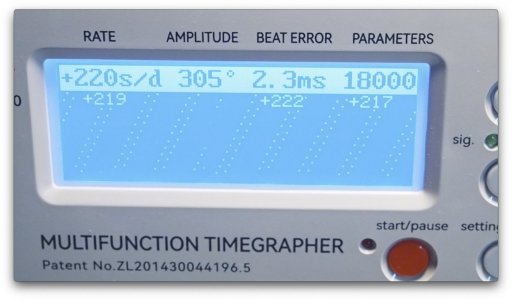

I decided to wind up the movement and put it on the timegrapher, just to see how its changed from before I began working on it. Before I took it apart, the watch was losing about 5 minutes a day, had a beat error of around 5ms, and the amplitude was only 115 or 125, I can't remember for sure (forgot to write it down). Ideally beat error should be less than 1ms and amplitude should be higher than 250.
Here are the results, after I disassembled the movement, cleaned it, relubricated it with the proper lubricants (three types of oil and one type of grease) in the correct places, and reassembled it:
Now, instead of running too slow by 5 minutes a day, it is running too fast by about 4 minutes a day. Amplitude is a very, very nice 305; and beat error is down to 2.4ms.
I thought the movement might have become magnetized, which can cause a watch to run several minutes a day fast; so after looking at the results shown in the photo above, I demagnetized it. It made no difference; so I suspect the man who 'repaired' it for me before did not do anything to the watch but move the regulator to make it run faster. That didn't fix it because it needed CLEANED, which I am certain he did not do. When I was disassembling the movement, it was full of dirt and lint. The jewels looked dirty, too. I could see dried gunk in them when I held them up to a light and looked at them through a loupe.
I cleaned it properly and replaced the mainspring and look at the result: good amplitude and now it runs fast. I can correct that when I regulate it later. I have to wait a few days for my new screw to arrive, so I am going to let the escapement run while I wait in order to let it settle in with the new lubricants. After I assemble the rest of the movement, I will then regulate it. I am confident I will be able to get it keeping accurate time to within a few seconds a day.
