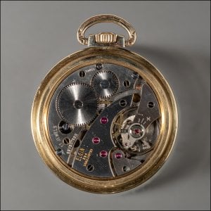

The swiss pocket watch is the Elgin, and it'll actually be easy to get in beat; it has a modern regulator with the hairspring stud on a moveable arm :D That one and the small Waltham both have modern-style movements, so those are the two pocket watches I am going to restore first.
The Elgin watch's movement. It is an ETA 6431-6445 movement; the ETA logo and model number is under the balance wheel. Should be easy to work on.

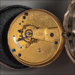

The two other watches are MUCH older. One was made in 1909, the other in 1869. Yes, 1869! 156 years old! Those two have similar looking movements, and they're strange. The entire movement is encased in metal, except the balance wheel, which sits on top of the case containing the rest of the movement.
This is the 1909 Waltham. I haven't photographed the 1869 watch yet; but it looks similar. I'm not messing with these ancient ones till I do some more research on them; I don't want to risk messing something up.

So ones like the Waltham I posted the pic of with the gold-tone movement are simple to work on? That's great! That one actually works; it runs when I wind it, but it runs slow. I'm guessing it just needs cleaned. The other really old one, which I still need to photograph, requires a key to wind and set it, and the guy who gave it to me didn't include a key. Fortunately, replacement keys seem to be available cheaply online. I need to measure it and see what size key it takes so I can get one. It would be cool if I can get both of those really old ones running. One is 116 year old and the other is 156 years old!

I'm guessing from the age of your watch that it has a movement similar to the other two early watches I have, like this one:
GMOG is saying that they're simple to work on; once I get to mine and see, I might be willing to work on yours. I want to do mine first for the experience.
It's the one in post #34 :)
Yes, the 18S watches are simpler and larger, with fewer parts, which makes them good candidates for learning. One challenge with them is not having the same kind of access to the escapement that you do with later designs, but this is a small thing. And like I said before, mechanical wear and other issues caused by previous watchbreakers are the main challenges with watches that have been around for a long time.

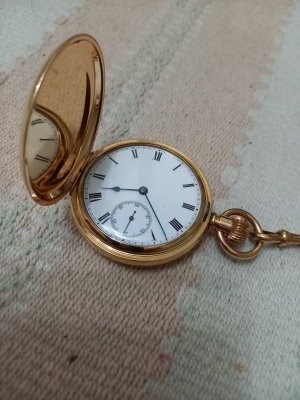

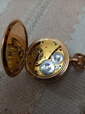

Chris, you reminded me of my watch. Originally my great grandfather's, as far as I know it went unworn between his death on 1916 and my sister's wedding in 2002. I decided to wear it as a family piece, and kept taking it out and opening it through the evening. Suddenly I realised it was running, for the first time in 86 years!
I'm a scientist, I know most things have logical explanations, and I know what the one for this is, but it still felt pretty damn special seeing the second hand moving and hearing it tick!
It has been professionally serviced since and, as a pocket watch, it comes out when I need to scrub up and put a suit on.
Mine is a 1911 Waltham Traveller, in an English case. I think I'd love it c even it wasn't a family piece as its so tactile!
