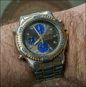

I do too. My first good watch was a Seiko. When I graduated from high school in 1994, my parents bought me a Seiko Quartz Chronograph as a graduation gift. I recently found the box it came in, and the receipt was inside; it cost them $399 back then, 31 yrs ago! I still have it and I still wear it. It still works flawlessly, but the crystal needs replaced; it has a mineral glass crystal and it is badly, badly scratched up from 3 decades of wear.
Sometime when I have some extra money, I'm going to buy a crystal press and then I'll get an install a new crystal in it.

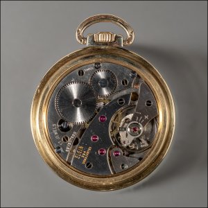

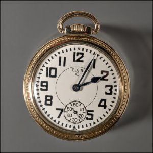

This Elgin was made in the 1950s, possibly 1960s; some of the sources I found say 50s, one says 60s. It has a Swiss made ETA 6431-6445 movement, which will make it easy to get a new mainspring for; since ETA movements are so common. Earlier Elgin watches were made in the USA with American-made movements. The Swiss made ones were near the end of the company's life.

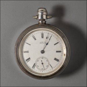

This Waltham was made in the USA with a USA movement in the mid 1920s. I got it running after winding it by nudging the balance wheel, but it stops every few minutes. Needs cleaned out and relubricated. The movement is beautifully decorated!

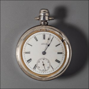

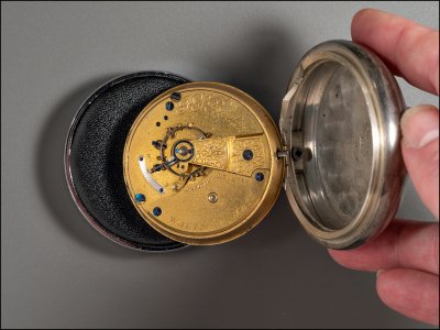

This is a P.S. Bartlett Model watch made in the USA by the American Waltham Watch Company. This one is old; it was made in 1909 and has a sterling silver case. The design is unusual; the movement is on a hinge and comes out through the front after you unscrew the bezel and crystal. I've never seen a design like this; the balance wheel is mounted above the rest of the movement and is separated from the rest of the mechanism by a metal plate that covers everything else.
This one actually works; it began running when I wound it up, but it is running slow. It'll need service, and the strange movement design will be a challenge. There is a fourth watch that Maurice gave me, and it has a similarly designed movement. It looks even older than this one, but I haven't researched it yet. I think that one is a lot older because it is wound with a key, like a clock. I don't have the key, I'm going to have to find one, so it'll be the last one I do anything with.

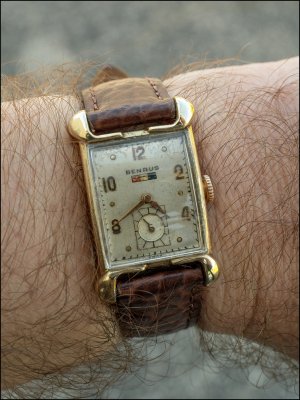

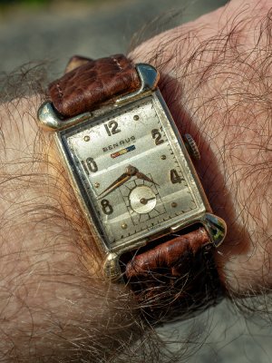

Last night I completed the re-assembly of my grandfather's 1955 Benrus Citation Copley wristwatch, which I disassembled to a pile of parts, cleaned, re-lubricated, and rebuilt. I'm wearing it now; the pics were taken a few minutes ago of the rebuilt watch.
Before I worked on it, it was running very slow, losing 5 minutes a day! Now it is running +5 seconds a day; which is exceptionally good for a mechanical watch, especially one 70 years old!
It does have too much beat error, 3ms. This watch does not have a moveable lever holding the hairspring stud like a modern watch. To correct beat error, you have to remove the balance from the movement and then turn the collet that holds the other end of the hairspring to the balance shaft. This is not something that looks easy to do without risking damage to the hairspring. Since I am a beginner to watch repair, I am going to leave that alone till I get more experience; then I'll take this one back apart and try to get the beat error down.
You're smart to leave the beat adjustment for later.
I don't "beat" myself up over beat error. As long as a stopped, run down watch starts after a few turns into winding I'm happy. Also, I tend to go by visuals more than numbers. If when the watch is run down and stopped the pallet fork is lined up more or less on the center line then I call it bueno. I also look for the escape wheel tooth that's engaging either of the pallet stones to rest on the impulse surface of the stone. That way self starting is almost guaranteed. If you've got the pallet fork lined up on center but the escape teeth aren't lining up with the pallet stones like they should then you have other problems.
