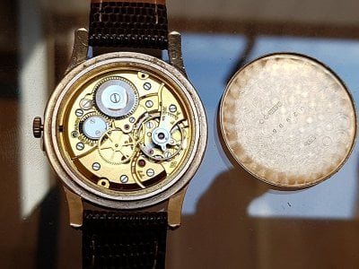

Several years ago, my grandmother gave me a watch that belonged to my grandfather, John Westerfield.
Grandpa died back in 1999. The watch Grandma gave me was a Benrus Citation Copley, a gold-plated watch made in Switzerland by an American company in 1955.
It ran but was very slow, losing about 10 minutes a day. Last year I got it out and decided to have it serviced. I didn't feel confident enough in my abilities to do a full service on a watch, especially one so old when no parts are available; so I took it to a local watchmaker. He returned it to me running just as badly as before, even after I asked him to work on it a second time. I decided not to take it back to him again. I recently began the process of servicing the watch myself, beginning with completely disassembling it.
The watch has an ETA 1220, a common Swiss movement from the 1950s. In the next couple days I'm going to clean all of the parts, then lubricate each part that needs oil or grease using the correct lubricant (there are four types of lubricant used in a watch, depending on what part is being lubricated!), then I'll reassemble it and adjust it for accuracy.
Before I took the watch apart, I wound it up and put it on a timegrapher, an electronic device that gives information about how a mechanical watch is running. The things I looked at were its timing (it was running about 5 minutes a day slow at that point) and its amplitude. Amplitude is a measure of how much power a watch's mainspring is delivering to the mechanism. It should be higher than 250 at minimum. This watch had an amplitude of 125. That showed me that the person I paid to repair it didn't do a damned thing to it. Two things can cause low amplitude. A worn out mainspring, and bearings that are full of dried, dirty old lubricants. Cleaning a watch solves the latter problem; and replacing the mainspring, which is a standard part of a watch service, solves the former. When I took it apart, the mainspring looked old, and the jewel bearings looked dirty when I looked at them through an eyeloupe.
Hopefully I can get it running perfectly again. The parts don't look worn or damaged, so I think it just needed properly cleaned, and a new mainspring. I found a company that still sells mainsprings for this old movement.

Chris, you are a brave man! Seeing that hairspring curling across the picture freaks me out -- how to return it to its proper configuration? But it looks like you have gone into this with eyes open.

I'm replacing the mainspring with a brand new one. The new one came pre-coiled in a holder that lets me push it directly into the mainspring barrel. If I were going to reuse the old one instead of replacing it, there's a special tool called a Mainspring Winder that is used to tightly coil it so it will fit back into the mainspring barrel.
