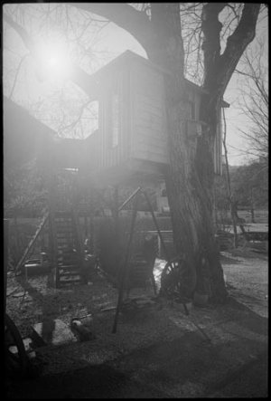

orange filter, chm 400 / kentmere 400 / apx 400 @ 800 in hc-110 loaded m2
orange filter, chm 400 / kentmere 400 / apx 400 @ 800 in rodinal 1:25 (I fought the fog with contrast!) loaded m2
By the way... the first two were shot with the "bubble copy". I think it's noticable softer than the pictures I took with the mint version.
