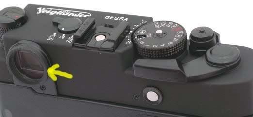

Where can I order a Bessa eyecup?
Grey Thumper
1:55 PM
Dec 14, 2009
11
Well, I guess technically it isn't a "cup", but more a threaded metal ring with just a bit of rubber to keep eyeglasses from getting scratched:
Mine simply unscrewed and fell off somehow. It's a pretty nonessential part (I guess that's why I haven't found a camera store that stocks them). The only reason I'm looking is because I do wear eyeglasses.
I think all the normal Voigtlander retailers sell them (CQ, PhotoVillage, etc.). Nikon FM eyepieces do fit, but remember that the Bessa diopter is neutral and the Nikon default diopter is -1. Also, some Nikon diopters don't have a rubber edge.
Same thing happened to my ZI, and I got a Nikon 0 diopter. I actually like the fact that it lacks the rubber bumper, which got caught on my clothes and made the diopter unscrew itself.
.... Nikon FM eyepieces do fit, but remember that the Bessa diopter is neutral and the Nikon default diopter is -1......
This has always been confusing. I think that the standard Nikon eyepiece has a diopter of zero but the viewfinder mechanism has an overall diopter of -1 (which is typical). So the standard eyepiece glass has no value, it is flat glass. But the Nikon "-2" diopter is a -1 piece of glass because it takes into account the combination of eyepiece plus viewfinder system. And so on with all the other values. The Nikon system has no "-1" diopter listed because it is the standard flat eyepiece. B+H list one for the FM but it has no rubber,
