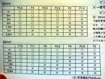

How important are those screws? I got a Helios from Fedka but both of the screws were stripped. I doubt it was already adjusted for S mount since I had to file the lock tab on the lens.The Nikkor-H 5cm F2, later black version is lighter than the F1.4. It is a Sonnar formula lens.

The Helios is calibrated for the Contax standard. The lens will usually focus behind what the RF of a Nikon camera indicates.How important are those screws? I got a Helios from Fedka but both of the screws were stripped. I doubt it was already adjusted for S mount since I had to file the lock tab on the lens.

Here is a chart from Cosina showing where a Contax lens will be in focus on a Nikon mount camera. The O is ok, the X is not.How important are those screws? I got a Helios from Fedka but both of the screws were stripped. I doubt it was already adjusted for S mount since I had to file the lock tab on the lens.
If you can get the screws out, turn the optical block one half turn out, and replace with good set screws, you'll be fine but otherwise...
The Helios is worth the effort - it's a wonderful lens, arguably the best truly Soviet design as it did not come from something pilfered from Germany. If you can't get the screws out, I'd suggest selling it to someone with a Kiev camera and getting a different Helios instead.

A slightly-off-topic thought: as the difference between Contax and Nikon RF is exactly the same as the difference between Soviet LTM and true LTM, this chart should apply there, too.Here is a chart from Cosina showing where a Contax lens will be in focus on a Nikon mount camera. The O is ok, the X is not.
