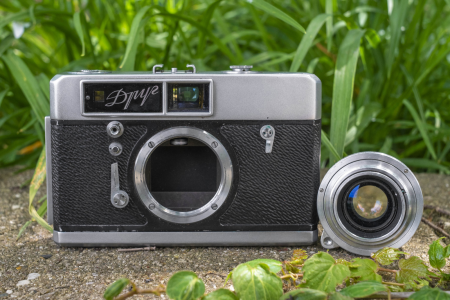

This actually links in nicely with a rumour I heard a while back. If you take the lens off a Drug, you'll find a regular LTM cam follower, and not the Soviet sled:I have seen several copies, most recently a Jupiter-8 that required no work and worked perfectly on LTM. There were still aluminum shavings in the mount so the chance of someone having "been there" are very slim.
Sometimes when the lens has its passport you can even see it before buying. For example I have a mid 1950ies Jupiter-3 that is specified as 51.7mm on the passport, which is within tolerance what even Leitz themselves allow, and lo-and-behold it focuses perfectly with no work required on my end besides cleaning out the hardened grease and fixing the gummed up aperture. (Edit: I should add that humorously 51.7mm is out-of-spec for the -/+1% tolerance they give - but Russia gonna Russia.)
Now, as I've mentioned on here before, that's a bit odd. The Soviet "sled" allows for total adjustment of both ends of the rangefinder linkage, therefore accommodating both the Soviet spec and the LTM spec with a bit of fettling. The Drug reverting to the roller means that's not possible... so the theory goes that batches of Jupiter lenses were made in LTM spec specifically for use with this more "premium" camera. If you've found/seen Jupiter "passports" with 51.7mm given as the focal length, maybe it was intended for use with these (or even for export).
But at this point, unless we can find someone who worked in the offices of KMZ in the 50s and 60s, it's all speculation. I know I'd like to properly test a Drug to see what specification the roller cam follower is set to - if a Leitz lens is fitted and the rangefinder and lens' focusing scale agree at 1m, it'll pretty much prove this theory. I'm not about to track down a Drug for this reason alone, though!
