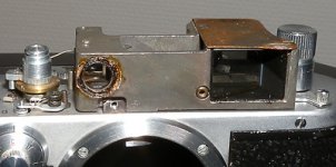

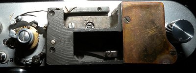

Can somebody explain a bit more in details than one of the "headline threads" on how to adjust the vertical alignment on a Zorki 3. The moving image in the VF is a bit to high so I want adjust it a bit down. I have removed the top cover as shown at the two pictures. How to proceed?

It lookes like the round window had been glued in place. Does this look like it can be rotated, same as the vertical position adjustment for the Leica screwmount cameras?

Yes, I think so.....and now I understand better the previous explanation in one of the threads in this forum. The round window is a prism and not just a piece of glass? .....it is locked with some shellack and I probably need some alcohol to "unglue" it.
Thank you!
Max
I hacked a fix, and it is still working. I've done this on one of my Zorki 3M's, and a Kodak Signet 80. Neither had an adjustment for the Vertical alignment.
I put some foam rubber on top of the mechanism above the RF window so that when the top plate was on the camera, it exerts a slight force to press it down. After all these years, the mechanism seemed to require a little push into place. It worked.
Clean the crusty brown stuff around the RF wedge collar. It will go off easily with acetone. A Q-tip liberally moistened with this solvent will do the job, and have lots of spare qtips ready. Let some of the acetone seep in since the shellac may have seeped in too.
Once the old glue is off, you should now be able to turn the wedge freely. The wedge was cemented because it was prone to move and readjustment always required the lengthy top removal to access it.
If you've ascertained the position of the wedge (do this several times- with and without the top cover off, with the eyepiece in place to make sure), fix the position with nailpolish. Red is better than black, in case you need to do some future repair, it will be easy to see which to remove. Nailpolish is easier to work with than shellac. And nothing to prepare too, for the tiny amount you'd need to cement it. A tiny dab in 2 or 3 points in the wedge's collar should fix it to its mount.

Thank you very much for the explanation. I have also previous used glue used for gluing wood to fix positions of glass in cameras. I may try this also here.....

If it's well and truly stuck and you can't rotate the prism, it's possible to adjust the mirror behind instead. See the "HOW TO CLA - Zorki 4K" sticky for pictures, the Zorki 3 uses the same VF/RF mechanisim. Beware that the adjustment is much coarser than using the prism and will require only the tiniest of alterations to the screws!
I tried to remove the shellac and dilute it but was not able to rotate the prism and I didn't want to use to much force. So I assembled the camera again. The vertical error is not that big so I think I can live with it until I one day may send it to a more experienced repair person.
That's no surprise. The collar is pried out via its two flat sides
in small increments, then turned, esp. when the shellac is that
stubborn.
If you decide to have another go, first thing I'd do is get all that
old shellac off of there (Ace HW acetone), then mark the
original position as ZK says. Dab it again, then pry it out,
one side then the other. Clean the collar up, reseat it, check
alignment, and when it's right put a small dab of adhesive
on each side. It'll stay put. You won't have to turn the collar
much more than 1 mm from the sounds of it. Good luck.
