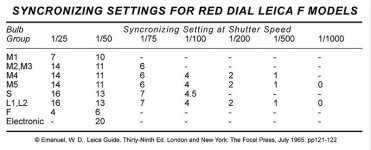

Here are some better tables
Table 1-Common Flashbulbs and types, in groups for the other tables
Table 2-Flashbulb groups and guide numbers (for ASA 32!) this may help with the unknown bulbs
Table 3-Sync settings for RED dial f's
Table 4-Sync settings for BLACK dial f's (and converted c's)
There was another table in my focal guide for converted II's, III's and IIIa's with the dial. If anyone wants that table, I'd be happy to provide it too.
All info © Emanuel, W. D.. Leica Guide. Thirty-Ninth Ed. London and New York: The Focal Press, July 1965. pp121-122
