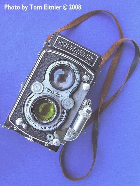

I just received today in the mail, the two remaining cameras from the estate of the 9th Armored Division Solider who also owned my 43' Leica IIIC K.
These two cameras also accompanied him home from the war in 1945.....
Both cameras are in amazingly good condition, having spent a very long time in cases, I cleaned them both with some warm soapy water and rubbing alcohol, now they both look respectable, the Contax case is very nice still and has some knife carvings on it stating it`s a 1938?
Also there`s a very neatly embossed number on the outside right front of the case ~ 178712 and the Sonnar f2/50 is #2200347 and is pristine, crystal clear as new.
Whoever knows Contax well, please write me, while I want to check this camera over well but know NOTHING about them.....sorry guys! I`m a Leica nut and this is my first and more than likely my only Contax I`ll own ~ *I tried to open the bottom to check the serial number and I can`t get the camera open? I also haven`t been able to check the shutter either.....I don`t want to muck anything up, so Contax guys write me* @ winkermeister@aol.com
Ohh is there a Self Timer Arm missing on the front, or is that Flash Sync?
The Rollei`s nice, the case has seen better days, but it still has a nice everyday strap and the speeds seem to work, the serial number is #710483, and It`s got a nice little Yellow filter, and twin metal pop-on lens cap.
I plan on keeping both cameras together with a very small photo of Martin with the IIIC K now, I sadly don`t have any photos taken with these three cameras back when they were in Germany, boy! If all three of them could talk what a story they could tell.......

Nice Tom! I have a Rollei that looks a lot like that, excepting the gadget added on the right side (in your pic) of the camera. Mine is serial 6134XX, and I think it is an Automat from about 1939. Mine has a Zeiss Jena Tessar 7.5cm 1:3.5. I had to hand-stitch the case on mine - every stitch was rotten, but the leather was good. I haven't used it much, but I have a roll of FP4 loaded, waiting for the end of Keith's "14-day challenge".

Yes, I think? It`s a Automat 1 from 1939, I read someplace that they are`nt so common......
I need to find a knowledgeable Rollei Repairman in the USA....anyone know anyone, out there who`s good with Rolleiflex?
Would be kinda kool to build up a small kit of WW2 ERA Rolleiflex stuff, not too many people are using these anymore and the glass on this one seems really crystal clear!
