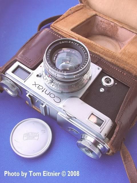

I just received today in the mail, the two remaining cameras from the estate of the 9th Armored Division Solider who also owned my 43' Leica IIIC K.
These two cameras also accompanied him home from the war in 1945.....
Both cameras are in amazingly good condition, having spent a very long time in cases, I cleaned them both with some warm soapy water and rubbing alcohol, now they both look respectable, the Contax case is very nice still and has some knife carvings on it stating it`s a 1938?
Also there`s a very neatly embossed number on the outside right front of the case ~ 178712 and the Sonnar f2/50 is #2200347 and is pristine, crystal clear as new.
Whoever knows Contax well, please write me, while I want to check this camera over well but know NOTHING about them.....sorry guys! I`m a Leica nut and this is my first and more than likely my only Contax I`ll own ~ *I tried to open the bottom to check the serial number and I can`t get the camera open? I also haven`t been able to check the shutter either.....I don`t want to muck anything up, so Contax guys write me* @ winkermeister@aol.com
Ohh is there a Self Timer Arm missing on the front, or is that Flash Sync?
The Rollei`s nice, the case has seen better days, but it still has a nice everyday strap and the speeds seem to work, the serial number is #710483, and It`s got a nice little Yellow filter, and twin metal pop-on lens cap.

Anyone know about the Contax? Is it a model II?
Tom
Yes, this is a Contax II. I think III is the one with the lightmeter and IIa and IIIa are the post-war models. The self-timer lever is indeed missing. The little button above the hole has an arrow on it, right? After the self-timer is cocked this button must be pushed in the direction shown by the arrow, to "fire" the timer. I think (but not sure) a Kiev self-timer lever would fit, if you want to get it operational.
Turn the two "locks" on the bottom, then put your fingers on the sides of the back of the camera and pull down.
The whole back will come off. Don't try to open by pulling the "bottom plate" off.
PS: Don't lose the take-up spools which will fall out.
It looks like the self-timer was removed to add flash synchronization. The Contax II wasn't flash synchronized, and many cameras had this feature added post-production.
The original owner might have had the self-timer arm or perhaps the person who handled the conversion kept it.
Your camera has the collapsible f/2.0 5cm uncoated Sonnar. It's a very nice and common lens. In fact, this seems to be the lens that you'll find attached to most Contax II cameras.
I've been shooting with two Contax II's recently acquired. The shutters are "just different". Being a long-time Nikon RF user, it's easy to get used to EXCEPT covering the RF window with my finger.
One came with a 5cm F1.5, the second with the 5cm F2. The F1.5 lens is unbelievable.
For some reason, the F2 front elements seem to have more cleaning marks than the F1.5. I'm not sure if they just were not handled as carefully, or if the glass on the front element is softer. I've worked with nine 5cm f2 lenses, and eight 5cm F1.5 lenses.

I finally got the back of the Contax off to expose the serial number
E 38657 ~ WHICH I PRESUME IS 1938?
The Shutter and Film Wind do`nt seem to work, the camera does`nt cock and fire, so it`s just a paperweight, does anyone know who`s the best repairman for Contax in the USA?
