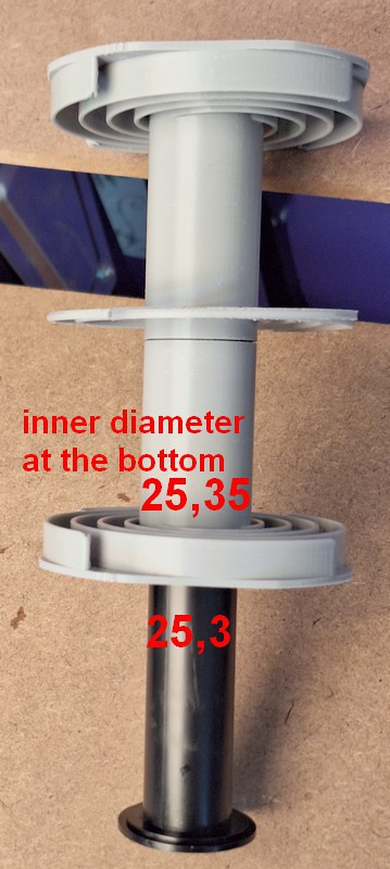

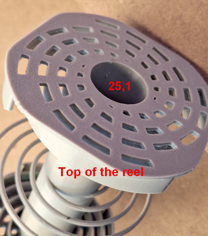

Good morning Joao!Hello
Are you aware of instructions to print a spindle that can be used inside a Paterson tank for large format negatives. I am dealing with this problem when I use a reel for 13 X 18 negatives.
I posted a detailed explanation here (with photos)
Maybe it already exists...It needs to be 13,5 cm long, max outer diameter 25,1 mm, inner diameter 22 mm![]()
Spindle for Large Format development
Blue Wind photos: Spindle for Large Format development -public.fotki.com
Regards
Joao
I hope I understood you correctly.
You need this black tube that's inside the reel.
Not the reel itself, onto which you mount the film.
Spiral for Paterson Developer Tank 13x18 (5x7") by bogdanbogvzyan | Download free STL model | Printables.com
Spiral for developing sheet film 13x18 cm (5x7 inches). Suitable for Paterson Multi-reel 3 tank. Holds 4 sheets of film. | Download free 3D printable STL models
www.printables.com
Diameter: 25.3 mm
Wall thickness: 1.6 mm
Length without the base: 138.7 mm
Total length with base: 142 mm
But you need this tube
with an outer diameter of 25.1 mm and
a length of only 135 mm.
These 135 mm are the total length with the base (base height: 3.3 mm)?
I could draw that for you, but I would increase the wall thickness from 1.6 to 2 mm to make it a bit more stable.
I hope the Yashica still works ;-)
Greetings: Dieter

Thank you Dieter. I think the total lenght of the tube, base included, is 142 mm - but I will confirm tomorrow night, as I am currently not at home. Its diameter must not exceed 25,1 mm - the core of the spindle gets narrower at the top... The thickness of the wall is not relevant as long as the lower tube of the light-trap funnel fits inside. It will be great if you can draw instructions for printing.

Do you have access to a printer?
Because I can draw it and sent you a *.stl file, but I have no possibility to test if it fits in the correct way.
So you have to print it and try if it fits the way you want it.
Otherwise you tell me what measures I have to change and you make the next testprint.

Hello
I confirm that the total lenght of the tube (Paterson spindle tube) is 14,2 cm. The diameter of the new tube should be 25 mm (maybe 24,9 mm is better, to play on the safe side). And yes, there is a guy living close to my house that prints - he printed my large format negatives reel.
If you can send the printable instructions for this narrow Paterson spindle, that would be great. But don't hurry, take your time.
Regards
Joao
Regards
Joao
