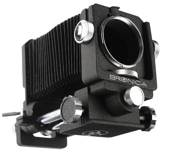

Bronica Bellows II, shown on Bronica S2 with 50mm f/3.5 H. Nikkor wide-angle provide much wider range of swing/tilt movements.
Bronica Tilt/Shift Bellows II on Bronica S2 with 75mm f/2.8 Nikkor-P. Note focusing helical has been removed to mount camera and lens.
The chief advantage if the Bronica Bellows II is that it offers a significantly greater range of adjustments than its predecessor while also beating bettering the Hasselblad 500 bellows system at every shift and tilt. The front standard can not only be shifted horizontally and vertically and laterally like the Bellow S, it can also be tilted and swung and then locked in any position. These actions let you shift the plane of optimum focus to suit a particular subject so you can, in practical terms, increase the depth of field and capture a sharp image without stopping the lens down as much or at all—just like a view camera. The unit itself consists of 3 parts—a tripod plate for affixing the camera via its tripod socket, with dual knurled fine-focusing knobs on the left and right sides, a lockable toothed rail that mates with the internal gears controlled by the focusing knobs and supports the front standard, and a square leather bellows that connects front and rear standards.

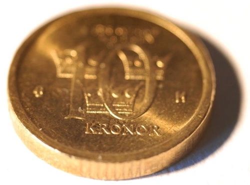

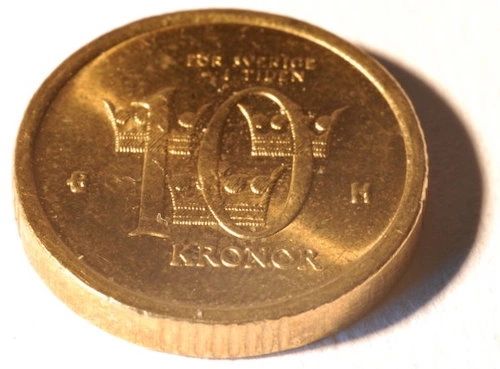

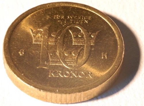

Based on the research of Theodor Scheimpflug, there are 3 distinct planes that determine image sharpness—the object plane, the picture plane, and the lens plane. When these planes are parallel to one another, picture sharpness isoptimized, but when photographing a 3-dimensional object, sharpfocus across the frame is attained only when all 3 planes intersect each other along common lines. View camera users understood this long before Scheimpflug quantified his observations and have compensated by using the swing and tilt movements of their cameras’ adjustable front and back standards. Similar but more limited adjustments are possible with the Bronica Bellows II, but since the bellows must be extended to take full advantage of these movements they’re limited to close-up photography. Also, since the Bellows II doesn’t provide auto diaphragm action, the unit incorporates an aperture lever that opens the lens to maximum aperture when you push it clockwise and hold it against spring tensionand returns the lens to its working (set) aperture when you let it go. The good news: The Bronica bellows II allows most lenses to focus to infinity! This is a huge convenience which again, Hasselblad could not boast about.
Closeup of 10 Kronor coin shot at f/4 with no swings or tilts used.
Closeup of 10 Kronor coin shot at f/16 with no swings or tilts used. Better, but still slightly soft in top area.
Closeup of 10 Kronor coin shot at f/4 with swings and tilts set to match subject plane is critically sharp overall.
