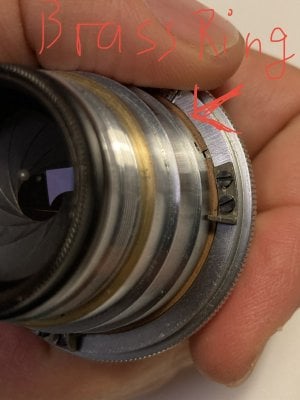

I have disassembled this lens multiple times, so maybe I can give some tips. I don't know your experience level so let me say this: You need a good lens spanner to work on this lens, a good set of small screw drivers and proper helicoid lube of different strengths.
The optical block separates from the helicoid via the slotted retaining ring which you see around the rear element. Only remove this very carefully and with said spanner, otherwise you risk damaging the rear element.
Once separated, there are many screws to remove: The screws on the mount side of the lens let you release the guide pin/helicoid key that regulates the movement of the helicoid between infinity and 1m. But there are additional stopping pins accessible from the front of the helicoid, which let you fine-tune infinity and 1m (see photo below). When you assemble the helicoid again, you need to calibrate the front guide pins so that the lens reaches infinity again.
After removing the screws at the front, you can take the chrome focus ring off in order to access the bare helicoid. There is another retaining ring on the front side which holds everything together. Again, use the spanner to remove it.

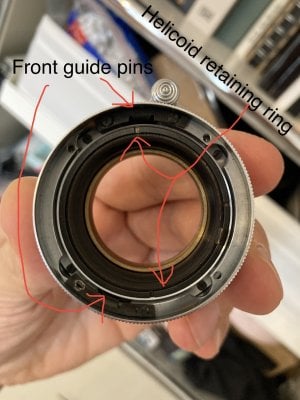

The lens has an interesting construction, it is a single helicoid, not a double helicoid. This makes it a little easier to find the correct setup of the helicoid when putting it back together. But make sure you document where the helicoid separates. You'll know when you put it together wrong because you won't be able to fit the helicoid key back into its slot when the helicoid is off.
The photo below shows the holes of the screws that hold the main helicoid key in place. The pin rubs against the inside of the helicoid tube, so for smooth focusing you have to lubricate the lower part of the inside of the helicoid tube, and underneath the front retaining ring. Use small amounts of medium thickness lube. The helicoid itself can take a lighter lube.

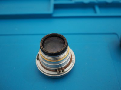

I feel like an idiot and didn't realize there was another retaining ring which I was able to unscrew, but the rear lens element doesn't seem to want to come out. It comes down a bit but gets caught and doesn't completely fall off. Is there any way to get it off? I was trying to get it off by lightly tapping on the lens, on my rubber work pad over a table.

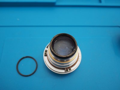

Actually there is usually no need for that as the entire assembly, meaning the rear group plus the brass casing holding it should all come out in one piece. For me these were never more than finger tight and I could always just unscrew them with the lens disassembled. Do you have a rubber stopper or something that you could use to apply a strong grip to the rear retainer without crushing or gouging it?
Just went and grabbed a quick picture of a junker I have on hand. There is no retaining screw or spanner slot anything, just a ridge for you to get a good grip with your fingers. It should just come out, like so:

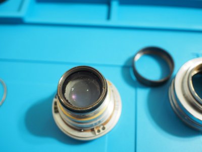

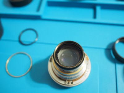

I was able to use the rubber lens tool to remove the ring as shown in the photos, but the rear lens element won't come out is what I meant. It seems to want to come out, but something seems to be stopping it, as it moves like 2-3 threads and it just doesn't fall out any further.
The picture you took helps, I guess mine seems really stiff, I think I need a latex glove or a rubber glass bottle openner or something to assist with, it is not budging for me.

Hope you can get it off. And I also hope the haze that I see on yours is cleanable. In my junker it sadly was not - whatever was off gassing from the aperture or the lubricant therein destroyed the coating of the surface facing it. That's not always the case, I had some come out spotless despite me expecting not be able to clean it, so don't give up yet!

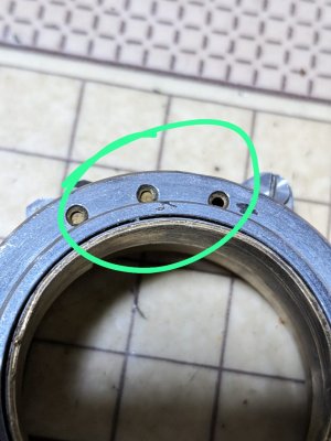

Hey can you help me.. I am stuck with Helicoid, I cant get it our, it seem the brass T shape lock for the infinity and close focus is hindering the rotation. Is there a way to remove T shape Brass stopper, though I had removed three tiny screws from the mount side.. you can also reply if youo like on my mail address @usmanifakhruddin@yahoo.com0c1d02c5-07cb-467d-b34c-7f667c1f6e53.jpgrews from the mount side...

You‘ll have to post some photos of where you are in the disassembly. It sounds like you are trying to reach the aperture mechanism from the back of the lens, but that is incorrect. Have you separated the lens block from the helicoid yet? That is the first thing you need to do. Post some photos of your current progress and I‘m sure people can help.

Thanks for the tips! I was able to get the aperture ring off tonight and have discovered that somebody else has been in here and removed/lost the grub screws that hold the aperture blade assembly in place, and allow the aperture ring to open and close the blades.
I was able to use some grub screws from a donor lens to get the aperture ring working, but they are a bit too long for the assembly to go back together again. I’m gonna keep hunting through my donors and see what I can scare up.
