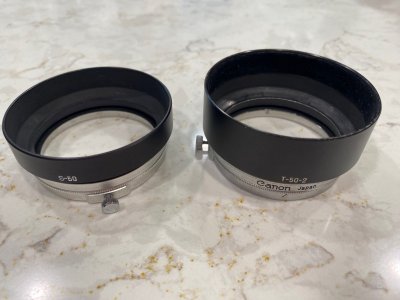

Thanks for the replies and photos. I have attached a couple of my Canon lens hood images and there is a difference between the S-50, T-50, and T50-2 as far as the length of the hood portion. The S (Standard) version is for the50/1.4, the T(Tele) versions of the 50 are (?), maybe 85/1.9 or the 100/F3.5 in the FL configuration, as the late RF 100/3.5 is T-42, or smaller, for the first generations. Also, Canon couldn't decide if they should be screw in or clamp on for the 135/3.5's?

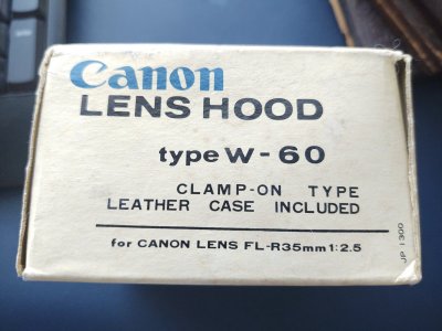

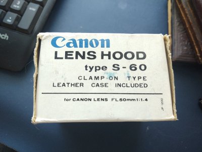

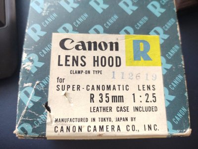

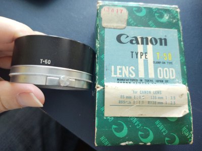

Here are some boxes, they list the lenses they are intended for. But as you have seen, some of the exact same hoods are labeled differently.
