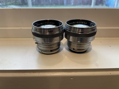

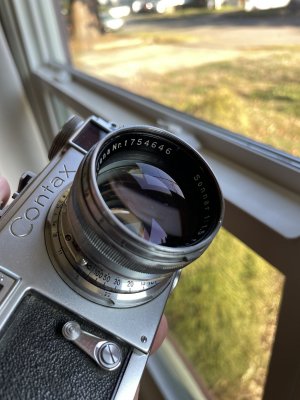

Here’s a recent acquisition that has some fun features: CZJ 5cm F1.5 #1,754,646
- Serial # indicates the end of v2 formula, but I don’t know how to confirm.
- Both front and rear elements are coated showing mostly a purple hue
- The lens is marked “Made in Germany twice — I haven’t seen the engraving on the back like that with many examples, but that’s probably because it’s always hidden 😄
It is a V3 Sonnar, I have one from the same batch and have worked on more. Mine, and one other in the batch both have coated front elements. These were made after the Vaccum deposition equipment was installed- and could be some "let's see what this thing does" lenses.
Good to know! Are "all" the 175 batch lenses likely v3?
Maybe we should rename this thread to "let's see what this thing does"...
I believe they are. I bought the 166xxxx Sonnar to take apart- and it is a V3.
My 175xxxx is the first Sonnar that I converted to LTM using a J-3. The focal length of my 5cm F1.5 is close enough to the Leica standard that is is accurate at F1.5 from close-up to infinity.

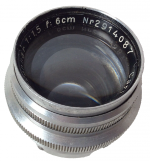

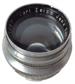

Here's an interesting one I just stumbled upon. Exacta mount.
A 6cm f/1.5 Sonnar in Exacta mount. Labelled Carl Zeiss Jena... Serial Number of 2.9million. So, post war and likely made under USSR occupation.
The 6cm makes sense here since it would need the extra flange-back to clear the flipping mirror.
According to my Thiele the serial number belongs to a batch of 28mm f/8 Tessars for Contax made in 1946. Strange...
Also interesting. Not sure what I make of it, yet.

More pictures at the listing:
I saw that lens awhile back.. very odd.
Part of me wonders if it's the same glass as the 58mm & 60mm Sonnars and someone went, "can you make one for my Exakta?"
That's what I thought, too but the rear lens group housing is very different from these "Sturzvisier" Sonnars. The timing would however fit. Also the rear group has a weird constriction in its optical path that I do not think is entirely down to balsam failure. Which again would be different.
I sadly do not know enough about Exacta from that period to say whether the design of the lens mount itself is odd or not. The knurling seems to fit. However the "skirt" which has the mount around the rear of the lens is odd and feels home-made. However that may be either due to wear and/or it being made after a devastating war where it was not easy to make stuff to the level of fit and finish of before.

Don't be fooled by the serial number. All the engravings have been made by someone other than Carl Zeiss Jena. No Soviet copy but German black market craftsman. The serial belongs to a Contax Tessar 2,8cm f8 from 1946. So no valid Zeiss lens in any way. To date such a lens is difficult. I haven't seen such kid of body yet. It differs from all other 6cm, 5,8cm Sonnars. I'm only sure that it was build after the war in Germany (and not by Carl Zeiss Jena).
Reading my first post (very carefully) one will find that I pretty much already wrote that. 😉
No offense taken, though!
I do find it interesting that the aperture engraving is a line akin to the wartime LTM (and Contax mount) Sonnars though. Most likely an (ex) Zeiss worker who took on some extra projects to get food for himself or his family.
Still does not explain where the lens comes from though. Again the rear section is quite different from the 5.8cm and 6.0cm "Leica" Sonnar lenses I have seen so far.
