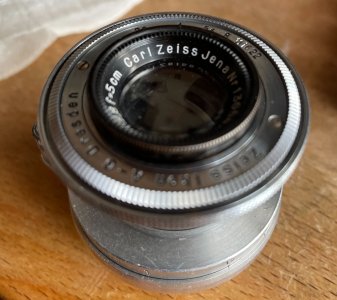

Thank you @TenEleven 👍 A lot of those points match with my evaluation. But I will try to give some more details for you all.
3001366 (to the right)
I bought this because I expected a Soviet copy. But it is a German copy probably made by a Zeiss Jena employee.
  • serial is valid (CZJ batch 72 from 1947)
  • unusual LTM Sonnar copy
    • concave rounded aperture grippers are very rare
    • sideways engraved focus scales are unusual and very rare
    • double aperture scales are unusual and very rare for CZJ Sonnars
    • unusual mounting portion, smooth ring below small grip ring
    • mtr engraving is unusual
    • diameter of rear lens is 23.6mm (!!!), it should be 22mm
  • this LTM Sonnar does not resemble authentic CZJ LTM Sonnar 5cm f/1,5
  • aperture scales rotates when lens is focused
  • name ring is authentic Zeiss Jena
  • most of the engraved numbers look very close to Carl Zeiss Jena engravings
    • 3 & 7 look authtic
    • 1 is not authentic and unique (never seen this kind of 1 engraved)
    • 4 is not authentic but looks close to
    • dots ( . ) instead of commas ( , ) engraved
    • engravings do not show Soviet origin or typical German black market origin
The strange mounting portion cause that when this lens is mounted to a Leica camera it looks like the lens is part of the camera. When I got the camera and lens I first thought that someone welded the lens in place. Unfortunately it was screwed with such a force that I had to use a wrench to get it off... After some inspection I came to the same conclusion as TenEleven that this is unlikely a Soviet copy but a remounted post-war Sonnar that was build by a Zeiss Jena employee.
The rear glass is unusual. The diameter is pretty off and there are no other known Sonnar 5cm f/1,5 (or Canon, Nikon, Jupiter) I know of that have a similar rear diameter.

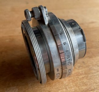

2792054 (to the left)
I bought this because I was hoping to get some hints of the origin of the 5,8cm Sonnar. Unfortunately this one answered no questions at all. 😅
  • serial is valid (CZJ batch 65 from 1942, 100 x Arri mount)
  • very unusual LTM Zeiss copy
    • I have never seen a copy like this before
    • very unusual deep filter hood
    • black arrow as aperture mark, black arrow as focus mark
    • turns till 1.3 meter, almost 360 degree turn
    • diameter of rear lens is 18mm (!!!), it should be 22mm
  • very polished metal, very light (144gr)
  • very smooth operation of aperture ring and focus ring
  • most of the engraved numbers look not authentic Carl Zeiss Jena but Zeiss Oberkochen
The rear lens does not look suspiciously small it is. With 18cm it is smaller than all Sonnar 5cm f/1,5 rear lenses. I looked into my measurements of the Sonnar 5cm f2 and even there is no 18mm rear lens mentioned. I think the shape of this rear lens is pretty strange too. I get the impression that someone assembled the lens and reversed the rear element. If you ask me what this means for the optical quality of this lens then I can say that I did some tests.
As you can see this lens offers a noticeable vignette when wide open. But it is sharp in the center (as good as the better Sonnars), light transmission look like a f1,5 lens.
Who made this strange Sonnar and why? The last part I might be possible to answer. The strange shape with the deep hood and the long focus throw reminds me of the Arriflex Sonnar 5cm. The long throw is advantages for cine lenses. The serial belongs to a Arriflex batch too. This would explain the unusual rear lens diameter too. It seems that the Arriflex Sonnars used a different shaped rear element. (I miss a lot of measurements for Arriflex Sonnars)
So who made it? Unfortunately I have 2 theories. First, maybe Zeiss Oberkochen or some black market craftsman could have made this lens after WWII. The fonts match the Zeiss Opton engravings and Oberkochen had the tools for this very clean and technical exquisite work. Or was it made in Japan today? The screw in front cap (size 48.5mm) is stamped with JAPAN. I know that some companies exists that rehouse vintage lenses for cine cameras. This one would be absolutely fine for Super 35. Unfortunately it is impossible for me to date this lens. It could be made 1951 or 2022. The housing would not show the age.

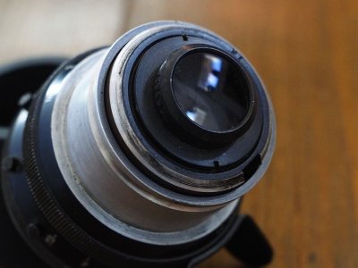

Another weird one showed up!
This one belongs to a small batch of known fakes in the 2407k range. The serials clash with a batch of Triotar 7,5cm f/3,5. They are mentioned in literature and showed up on Zeiss auctions already. People have insane asking prices for those...
Very interestingly the lens has one of those 6 slot spanner rear retention rings! People investigating the Sonnar 5,8cm will know what I talk about.

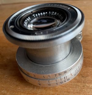

I do not have much to write about this particular lens, so I'll just chuck this in here:

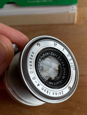

Took a gamble and bought a LTM Tessar 5cm f/2.8. After disassembly it was sadly clear that this lens would not be repairable due to the helical being so worn by use that it wobbled back and forth in the mount by about 1mm which obviously displaces both the rangefinder image and the seat of the lens itself. Even with the heaviest grease I could find it would still by the pressure of the rangefinder roller revert back to its bad state. So, sadly it's not fully usable as-is. After a bit back and forth I got a discount on it and for a sliver under $100 (at current exchange rate) I'll keep it as a historical piece.
The internal construction is quite solid with no stopper screw but two blocks of aluminum hitting each other to delimit focus travel. (Akin to the Summar for example.) The lens also collapses, which I found surprising, also it has its own bespoke focus scale which correctly starts at f/2.8 for this lens. The external appearance is quite similar to the collapsible 5cm f/2 war-time LTM Sonnar. However it just uses a single helical meaning the entire front rotates during focus.
The screws used are slotted screws made from aluminum, just like the mount. The lens being 1.5 million was finished in 1934, likely a bit earlier than the focus mount. But here is where things get a bit surprising. Thiele has this lens as a batch of 2000 being finished in a 24mm Compur shutter. What? I was dead certain I'd find "Contax" under the mount section... but no... very strange.
I should add that it is not possible to transplant the name ring etc. of such a Compur shutter lens into a Contax barrel. I have such a Compur set lens and for laughs tried to insert the front element. I did not get very far. This very obviously won't fit.

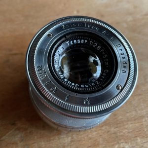

I have an idea as to the "why" - I assume that these Compur set lenses follow the Leica standard more closely and thus you can get away with a single helical.
But then the question becomes - who and how?
