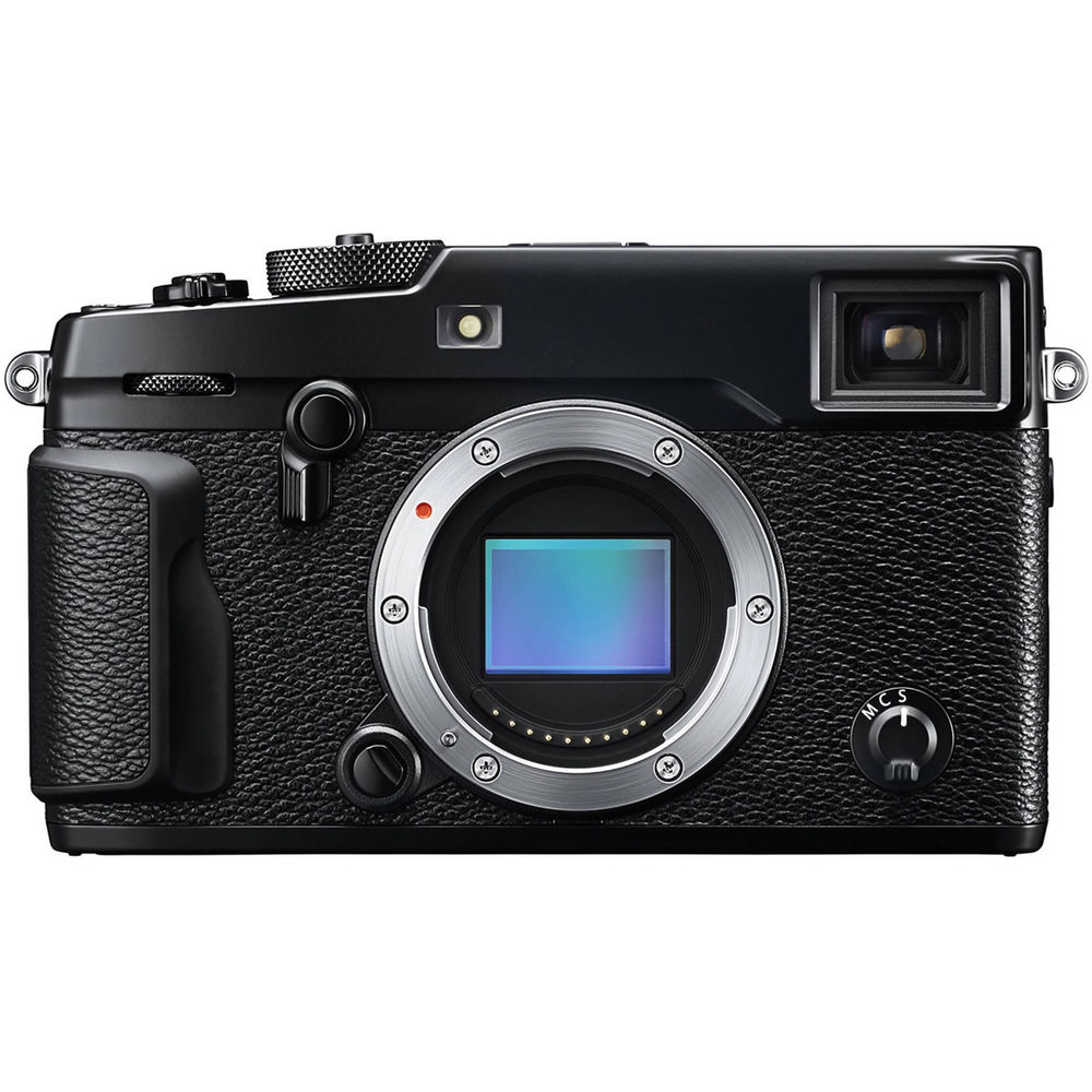

o-Tom-atic
I am really disappointed with the X-Pro3's OVF, which is the single reason to buy it. With just a single magnification level it is not attractive anymore. With the X-Pro2 the 14mm ± covers the whole area in the low magnification setting and according to dpreview 18mm is the widest lens you can use whilst on the 'tele' side the 50mm framelines are just a small part of the OVF's view area. This leaves the useability of the X-Pro3 limited to the 23 and 35mm lenses. What a shame. I would have been very happy with a useful (for me) 16-50 mm range, but that seems not to be the case. If I have to rely on the EVF most of the time, than a X-T3 is a much neater proposition.
Most of the time I use a 23mm or an 35mm on my Fujifilm. I wouldn't see myself using the OVF with my 90mm anyways.
Envoyé de mon iPhone en utilisant Tapatalk
FranZ
I wasn't alking about a 90mm. Even the 56 is unusable on the XP2's OVF because of the very narrow framelines and the OVF blocking, but at least I could use the 14mm and 16mm lenses. I had hopes for a range that would accommodate the fujicrons and the 16mm 2.8, but that is not the case with this single magnification viewfinder. I will check in the store when the XP3 reaches the shelves, but so far it is a no-go for me! Pity.
Ted Striker
Most of the time I use a 23mm or an 35mm on my Fujifilm. I wouldn't see myself using the OVF with my 90mm anyways.
Envoyé de mon iPhone en utilisant Tapatalk
You use frame lines with the 23mm lens when focused at or near infinity.
What an epic fail by Fujifilm.
Pál_K
Cameras. I has it.
An unrelated question:
In the optical viewfinder mode there is the white square "estimated" focus point and Fuji allows you to enable display of the actual focus point, which appears as a green square. As you get closer to your subject, and parallax becomes greater, the white and green squares diverge. Does anyone use this feature?
This was too much clutter for me, so I never enabled that feature. I thought that if I ever got so close where that precision mattered, I'd just switch to electronic viewing through the lens.
It's a shame that when the (green square) actual focus point is enabled, the white one doesn't go away.
In the optical viewfinder mode there is the white square "estimated" focus point and Fuji allows you to enable display of the actual focus point, which appears as a green square. As you get closer to your subject, and parallax becomes greater, the white and green squares diverge. Does anyone use this feature?
This was too much clutter for me, so I never enabled that feature. I thought that if I ever got so close where that precision mattered, I'd just switch to electronic viewing through the lens.
It's a shame that when the (green square) actual focus point is enabled, the white one doesn't go away.
The option to turn the back screen off already existed. Why was there a need to make it totally dysfunctional to those who might like to use it? I may rent one just for fun at some point, but right now I will hold off. I like to have fun with my cameras, not be hampered or frustrated by them.
It is not totally dysfunctional... there is a screen you can still use.
Out to Lunch
Ventor
Why not wait to like or dislike this camera until you've had it in your hands? Cheers,I like to have fun with my cameras, not be hampered or frustrated by them.
Dogman
An unrelated question:
In the optical viewfinder mode there is the white square "estimated" focus point and Fuji allows you to enable display of the actual focus point, which appears as a green square. As you get closer to your subject, and parallax becomes greater, the white and green squares diverge. Does anyone use this feature?
This was too much clutter for me, so I never enabled that feature. I thought that if I ever got so close where that precision mattered, I'd just switch to electronic viewing through the lens.
It's a shame that when the (green square) actual focus point is enabled, the white one doesn't go away.
Yes, I use it. I like it. I like seeing where maximum distant and near focus points are located within the finder.
gavinlg
An unrelated question:
In the optical viewfinder mode there is the white square "estimated" focus point and Fuji allows you to enable display of the actual focus point, which appears as a green square. As you get closer to your subject, and parallax becomes greater, the white and green squares diverge. Does anyone use this feature?
This was too much clutter for me, so I never enabled that feature. I thought that if I ever got so close where that precision mattered, I'd just switch to electronic viewing through the lens.
It's a shame that when the (green square) actual focus point is enabled, the white one doesn't go away.
It’s necessary to know where the autofocus landed. Without the close and infinity estimators you would have no idea. It’s actually a genius solution and and not at all distracting when you get used to it .
Ted Striker
It is not totally dysfunctional... there is a screen you can still use.
Just mostly dysfunctional. It's very telling that away from the fan boys, there is a HUGE amount of dissatisfaction over the X Pro 3. The comment sections for the various posts at DPR's news feed are very much against the stupid design of this camera. It is easy to see that this is not going down well. At all.
Just mostly dysfunctional. It's very telling that away from the fan boys, there is a HUGE amount of dissatisfaction over the X Pro 3. The comment sections for the various posts at DPR's news feed are very much against the stupid design of this camera. It is easy to see that this is not going down well. At all.
Yeah, people do not like things that move away from the norm. It causes them stress and discomfort even though they aren’t going to buy it.
Ted Striker
Yeah, people do not like things that move away from the norm. It causes them stress and discomfort even though they aren’t going to buy it.
As I read it, many if not most people are ready to upgrade from their X Pro 2 to the new 3. However, this asinine design from Fujifilm ruins that plan and now they have no upgrade path. Those saying just go to the XT-3 completely miss the point. That's not an option for folks who have enjoyed a rangefinder type camera for the past near 10 years. This is an epic fail from Fujifilm.
Well Ted, I honestly wouldn’t have expected anything but negativity from you. That aside, I do see the comments, but how many were really going to buy anyway? Dpreview is a gear head site that focuses on pure specs at the expensive of anything else. This is not a mainstream camera and that’s a mainstream camera site. I’m frankly shocked at how many people rely on a screen. I’ll admit, I’ve underestimated the demand. That said, the X-Pro2 is still very nice compared to this so people should be happy they don’t need to upgrade. Instead they go crazy that they can’t buy something new.
I’m not sure how a camera that isn’t even out can be an epic fail. And I guess I’m a stupid hipster because I like the camera and I don’t rely on my LCD a lot.
I’m not sure how a camera that isn’t even out can be an epic fail. And I guess I’m a stupid hipster because I like the camera and I don’t rely on my LCD a lot.
aizan
One last gripe: the X-Pro2 had the nicer top plate design.
Ted Striker
Well Ted, I honestly wouldn’t have expected anything but negativity from you. That aside, I do see the comments, but how many were really going to buy anyway? Dpreview is a gear head site that focuses on pure specs at the expensive of anything else. This is not a mainstream camera and that’s a mainstream camera site. I’m frankly shocked at how many people rely on a screen. I’ll admit, I’ve underestimated the demand. That said, the X-Pro2 is still very nice compared to this so people should be happy they don’t need to upgrade. Instead they go crazy that they can’t buy something new.
And I guess I’m a stupid hipster because I like the camera and I don’t rely on my LCD a lot.
The X Pro 3 should have been addressing the same market as the X Pro 2 did. That it did not is the exact reason why there is such a huge uproar of disappointment. It's pretty easy to see. I would be hugely upset if I were in the market for such a camera. My X100 fulfills my need for a digital camera and is very similar to the X Pro cameras. If Fujifilm is so stupid that they bring that asinine LCD design to the X100 type cameras, then my chances of upgrading drop to zero.
Taking away a fully functioning LCD and replacing it with a crippled one is a ridiculous design.
Especially since you can simply turn off an X Pro 2's LCD and remove it all together. Real simple. Problem solved for those who don't want an LCD.
The vast majority, repeat VAST, use the LCD as an advantage of digital photography. The idiotic screen of the X Pro 3 removes that advantage for no benefit.
Ok, I give up. This will be the death of Fuji!
Yokosuka Mike
Abstract Clarity
I predict that within 18 months the other major camera makers will be introducing new cameras emulating Fujifilm’s X-Pro3 back screen design.
All the best,
Mike
All the best,
Mike
arseniii
oooouuuch all that hate for Fujifilm! Do you folks get paid by Sony to seed negativity?!
Ted Striker
I predict that within 18 months the other major camera makers will be introducing new cameras emulating Fujifilm’s X-Pro3 back screen design.
All the best,
Mike
LOL! iCal'ed. We'll revisit this at the end of this time frame. I predict not a single maker will follow Fujifilm down this sewer.
Ted Striker
oooouuuch all that hate for Fujifilm! Do you folks get paid by Sony to seed negativity?!
I dont own one piece of Sony gear, aside from my TV.
back alley
IMAGES
there are no real negative comments...only fake news from russian trolls...
