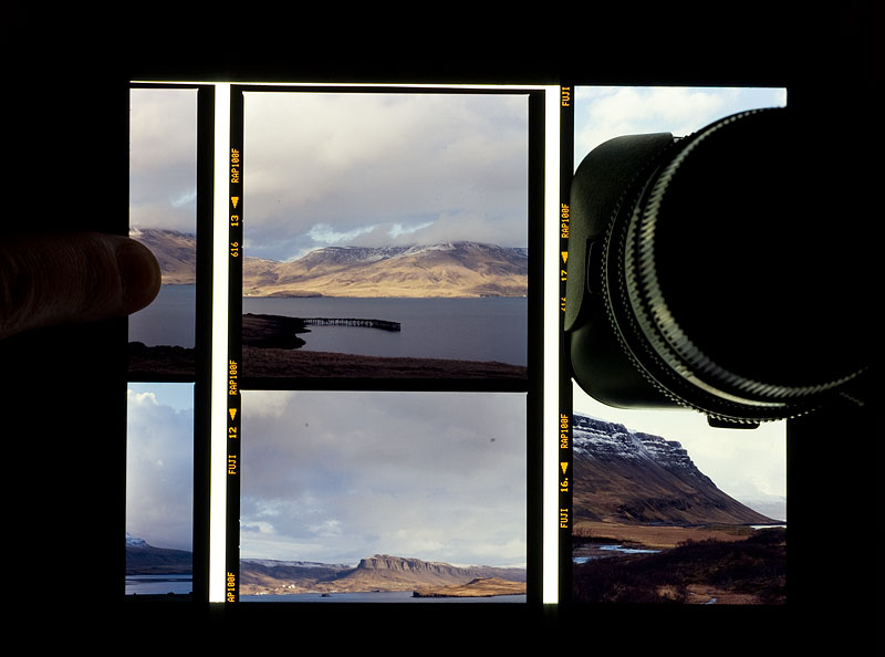

You will never get really good results from scanning 135 format positives on a flatbed scanner. Even the dedicated film scanners struggle. Positive film has a dmax upto around 4.0 which is simply too dense for a flatbed to scan through without showing a LOT of noise. The electronics are not nearly good enough. They claim high dmax values which might be true but being able to scan through is not the same as being able to scan without noise. This is why drum scans are so much better, they use a photo multiplier which is virtually noise free and adjustable sample dot size (called aperture) to maximise output quality.
All scanners have trouble with dense slides, even the very best. I scan professionally, and I still have to do a lot of work to get good slide scans...and I use a scanner that retails for 20,000 USD. A low-end Epson is not going to give you the dynamic range you need to capture the whole slide, so you will need to make choices -- block up the shadows or have noisy flat images. If you really want to enjoy your slides, I would sincerely recommend that you get a slide projector.
The DSLR option is also quite good. If you don't have one, you can try the M8 and a lens with a higher magnification factor -- the 75/2 is great for this, as would be the 90/4 Macro. Just put the slide on a light box, set the tripod up and photograph it. Crop it in photoshop. You will not get 1:1 on an M, but you would still get a nicely usable image for the web, along with better colors.

Thanks guys -- maybe I'll try photographing them. At the moment, my longest lens is a 50, I'm not sure if that'll work. But I could mount it on the E-P1, that would give me a bit higher magnification.
Photographing on a light box you would need a macro lens to fill the frame and a tripod etc. May work for web images hand held but not much good if you want to use result for digital printing.
one of the following would make life easy. The have a lens in them which turns your standard camera lens into a macro lens.

Wow. I just realised that by simply holding the slides against the light and photographing them with my Fujifilm FinePix F200EXR p&s compact in macro mode, I get better results than with the V330!
