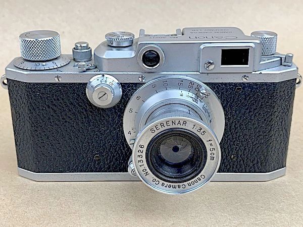

Canon IIB with 50mm f/3.5 Serenar lens: It established the form and features of the rangefinder series and may be the most important Canon ever.
The Canon IIB of 1949-1952 was the first Canon with a single eyepiece combined range/viewfinder that also incorporated Canon’s signature 3-step multi-magnification eyepiece (F for full 50mm view, 1.0x for 100mm view, and 1.5x for maximum focusing precision) that’s capable of providing an effective base length (EBL) long enough to focus wide aperture and tele lenses at the flick of a lever. This brilliant innovation took Canon one big technological step beyond the double eyepiece Leica IIIc, IIIf, and even the Leica IIIg of 1957-1960, and it was used on all subsequent rangefinder Canons up to the Canon P of 1958-1961, which showed reflected parallax-compensating frame lines for 35mm, 50mm, and 100mm lenses all at once. Other features: bottom loading, horizontal cloth focal plane shutter with separate front mounted slow speed dial with speeds of 1/20 sec and slower, a top-mounted fast speed dial with shutter speeds of 1/20-1/500 sec plus B, and traditional knob wind and rewind. The Canon IIB was made in early and late versions with minor variations and those made before 1952 are stamped “Made in Occupied Japan” on their base plates. Standard lenses: 50mm f/3.5 Serenar or 50mm f/1.9 Serenar, both collapsible. The Canon IIB is a lovely camera and fine user collectible, but it’s scarcer and often pricier than later Canons such as the III, IIIA, IVS and IVSB, which are better, more economical choices for vintage shooters. $200-$300, body only; $300-450 with 50mm collapsible lens.
