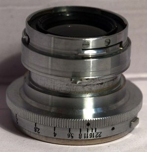

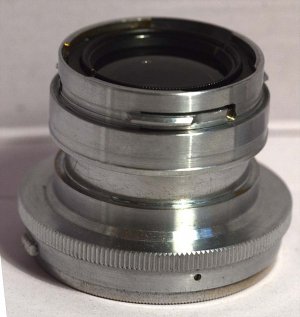

Sorry to say this but I marked this one as a fake. There are several points that are noteworthy.
  • the serial does not belong to an official production batch. It belongs to a Kipronar.
  • the numbers at the focus scale do not match the Carl Zeiss Jena fonts
  • the numbers at the aperture scale do not match the Carl Zeiss Jena fonts
  • probably the numbers at the name ring do not match the Carl Zeiss Jena fonts
  • totally unique barrel design with double grip ring
This all speaks a clear language that this Sonnar was not manufactured inside of Carl Zeiss Jena. It is a lens some call transition Sonnar here. It was manufactured by an unknown third manufacturer after WWII. Most of the time those lenses where made from spare parts in a German workshop. They used all sorts of metal and constructions. As Sonnar Brian calls it: one of a kind. I have never seen another Sonnar like yours. Consider it as unique.
If it is working and you can use the focusing of this lens then it is a great find. When I saw it first I did not know if it is complete and usable. The top part with the double grip looks strange. So I was skeptical if it is possible to focus this lens on a LTM camera. One image is not enough to answer all questions. Since you have this lens in your hand you can try it out and see for yourself if this lens is up for the task.
Even if I consider it a black market fake this says nothing about the quality of this lens. Could be the best Sonnar lens ever made. But to keep real it will probably behave like most other Sonnars made at the end of and after the war. My LTM Sonnar belong to the sharpest ones I own. So the chances are good to have a keeper in your hands.

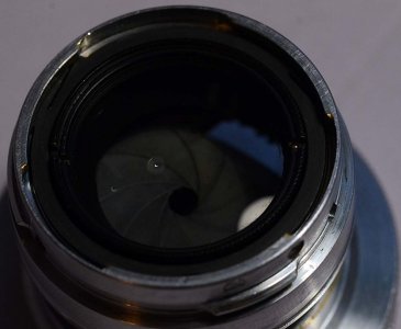

That's an interesting one. Is it coated? Is it marked "T"?
The focus mount portion looks like a repurposed Leitz Summar or similar L39 mount.
The slope of the name ring is steep like some of the early f2 lenses. Also the aperture adjuster "rabbit ears" have way too many engraved lines. The font is very small and the aperture ring is "too small" to be normal. And it has the slope on both sides that some have. The optical fixture wall looks quite thick in that photo - I think normally they are slimmer.
And of course the focus grip itself which has a very one-off quality to it.
Now all of this does not mean that the lens is a "fake" as in the glass is not Carl Zeiss Jena or that the lens is "bad" as a picture taker. It just means that it's a one-off production, likely by a displaced Zeiss worker or similar. Sadly due to the time that has passed and the fog of that chaotic history it will be impossible to make further deductions without at least disassembling the lens. and seeing if the rear fixtures are stamped.
If I had to take a wild guess, taking the above into account as well as the thick optical fixture - my bet would be "No, not going to be stamped".

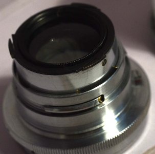

Herewith some pictures - do let me know if you want to see more. I suspect it's a "common or garden" variant, but to be honest it's mine, it's not going anywhere, just hoping it helps your research. I can tell you it's a chrome finish, Contax mount (You guessed that from the pic on the Contax, though), 9-blade aperture, f22. I do not intend to take it apart to show you fine points of its innards, sorry!
Given that I have some unexpected time available I really must sort a tabletop studio, you can tell by the sharpness or lack thereof that I've done these handheld, and it's far from great!
