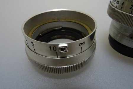

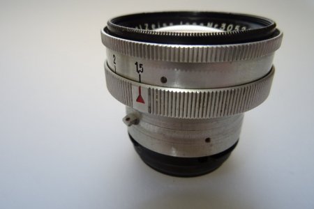

I recently purchased a Carl Zeiss Jena Sonnar 1.5/5 cm lens. Judging by the serial number, this lens was produced at the end of 1947.
It is a Sonnar lens for the Contax rangefinder, with an adapter to LTM.
It seems an original combi, but we haven't actually been able to find any further information about it on the internet.
Does anyone know more about this lens, is this original? Was it sold as one piece, and is there any background information about this lens combi?
Thanks!

Definitely a Post-War CZJ 5cm F1.5 Sonnar, with a beautifully made custom adapter to go with it.
I have seen some custom and low-production adapters done at the time- but this one is beautifully done. The focus mount includes the Contax Mount itself, and it is all internal.
Are there any inscriptions on the inside of the mount?
I do suspect that it was made to match your lens. It looks like a Shim was used as part of the adapter.
The lens looks authentic. The adapter shows again the wrong engravings. It is not made by Carl Zeiss Jena. I have never seen this kind of adapter. It is hard to tell who made the adapter. If you compare the numbers on your lens and the numbers on the adapter you will see differences. For example the 4 is different and even the zero. All I can say is that it was made in Germany after the war. But since we have not solved the black market puzzle yet it could be made by everyone inside East- or West-Germany. As Brian already stated a beautiful and skillful piece nevertheless.
About the black focus arrow. Does it have the same size and shape as the red arrow on the Sonnar lens? Zeiss Oberkochen (West Germany) used a tiny bit smaller black arrow on their lenses with rounder corners compared to Zeiss Jena (East German). If the corners are not rounded at all it would point to Soviet or a very early work.
Nice adapter, what's also interesting is that the focus throw is almost the full 360 degrees. That's even longer than the Contax (with about 260 degrees of throw from infinity to 0.9m) from which the lens came.
