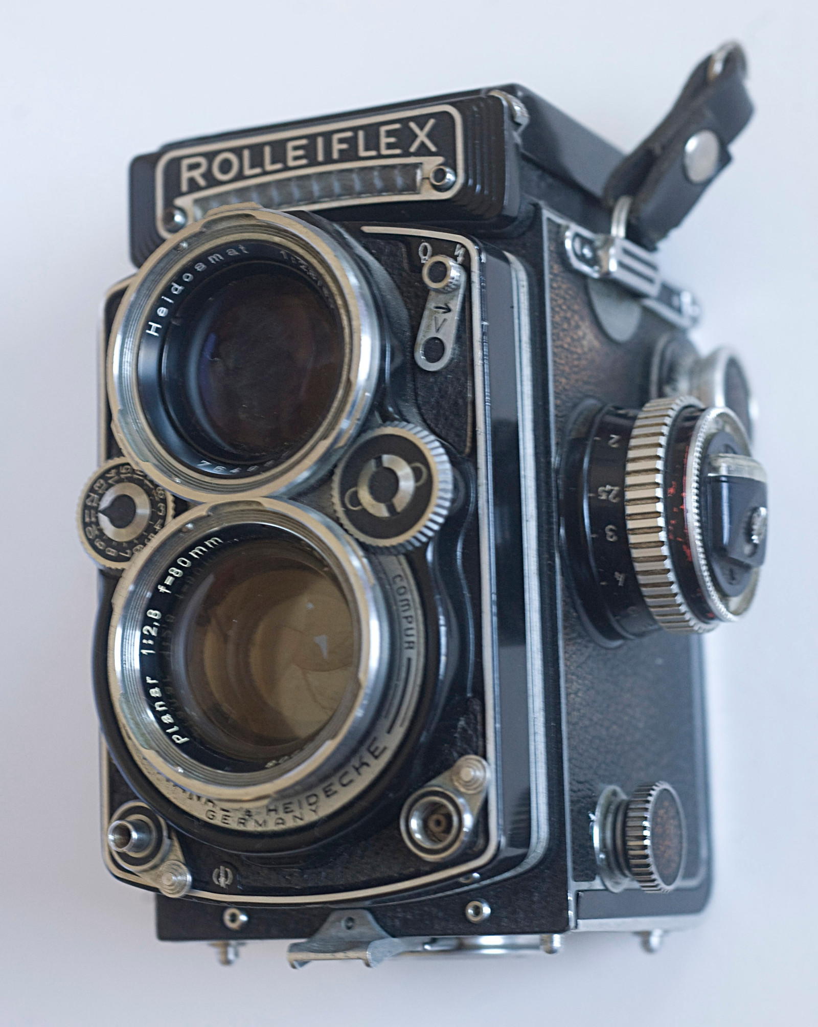

I am looking into potentially buying a Rolleiflex for the odd portrait work.
Here is one I came across.
Can someone elighten me which model this is? My limited knowledge tells me a 2.8E. What should I look out for when buying? Shutter time are, according to the seller, "OK". He does not provide much more information.
How hard is self-servicing on these? I had a 3.5 one a few years back. Did not suit my shooting style, but now I can see myself using one. Alternative is 500 c/m Hasselblad.
Yes, 2.8E. If the meter is working and accurate, that's a bonus -- don't make that the deciding factor, but I would certainly say a camera with a working meter is worth more than one with a dead meter, all other things being equal.
Yes, the shutter speeds should be accurate(ish). Also, you will want to look at the taking lens to see whether there is any decementing of the lens elements. (There's a rather recent thread on RFF about this -- the 2.8s are more prone to it than the 3.5 Rolleis. Not necessarily fatal -- the camera may take perfectly fine pictures -- use a lens hood though. And decementing is definitely grounds for a price reduction.)
If you get the camera, invest in a hood and a Rolleinar 1 for portraits.

Another vital check: the front unit moves parallel to the camera body and retracts until fully flush with the body. If it is not aligned, the focus will be off.....trust me! If the meter is not coupled, it is an "e." Greatest camera ever alongside the Leica
it doesnt have to be flush just equal on top and bottom. over time the lens plate bends inwards from depressing the shutter button (or for other reasons it is bent, these are 70 year old cameras) and a tech can fix this and if it's been re-aligned the lens plate wont always be flush with the body but the silver plate between them should be showing equally on top and bottom
they are almost ALWAYS bent if it wasnt kept by one owner and babied. they can be realigned, but ask for pictures of each side straight on with the lens focused to infinity (retracted fully into the body)

Yes, it's an E from the late 1950s. Looks (reasonably) okay cosmetically, mechanically who knows?
Many Es were used by studios and flogged to death, doing everything from portraits to commercial assignments to copying customers's snaps. They may look okay but are often badly worn and will often cost more than the original buying price for a professionally done CLA or repairs.

The 2.8E is a fine camera. As long as the taking lens is clean with no separation, little or no scratches it’ll be fine. Spend $50 on a Mamiya RB67 screen and bring camera for CLA and have the tech cut to size and install the Mamiya screen. You’ll have a camera good for another 20 years for little money. $500 plus $50 for the screen and $150 for the CLA.
As with most things, buy the one in the best condition. Beware of corrosion of the aluminum body, and lens separation. Any signs of trauma (bent items) should have you steer away, as the two lenses are likely to be out of alignment. I have the 3.5F, 2.8F, and a Tele Rollei. Yet, if I use a TLR, the one that I use the most is a Minolta Autocord. That one is compact, light and it has a great lens.
