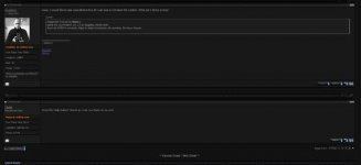

Does this help Gabor? Weird as I can see them on my end.
I noticed the same with Huss' photos recently, while most other posters' photos show up just fine. I normally use Chrome, but Huss' photos seem to load normally in Safari. I dove into the Chrome settings, but I couldn't figure out why Huss' photos show as broken links.
Thanks Gabor! I'm posting using an iMac and Safari. I jut checked Chrome on my iMac and it still works. It's a mystery...
Well, I think I just solved my mystery. I'm using the HTTPS Everywhere extension in Chrome, and disabling it resolves the issue with Huss' broken links. Among the sites the extension is forcing to an encrypted connection is Photobucket, which I think is where Huss is linking his photos from.
Thanks a lot for the information! I use the same extension with Firefox.
