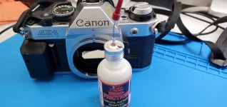

Unless I’m mistaken, that common sound with those cameras is not from the shutter but rather from the mirror-lift mechanism.… (it does have the puppy sneezing sounding shutter, but I'll get around to lubricating that and for now, the speeds seem to be fairly accurate)…
Correct. I think is the ball bearing that lifts the mirror that gets dry of lubricant.
Thanks y'all! You are both correct and I misspoke (or miswrote). I'm failing my precision of language habits! It is inded the ball bearing in that escapement in need of a lube which squeals when I fire the camera. As soon as my Amazon next day delivery comes with a needle oiler, I'll do a little minor disassembly to get just a drop in the right place.

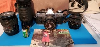

It's a cute little camera...in program mode, I can almost treat it as a point and shoot (that just needs a little focus help).

I am glad it is working again.Five minutes et voilà, no more squeak!
