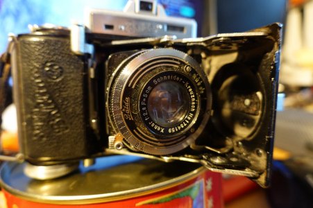

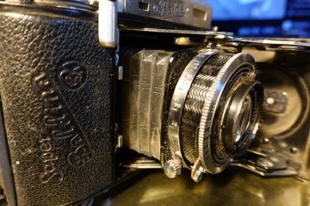

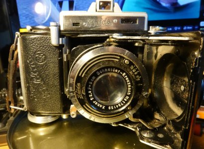

just got this very interesting Balda Super Baldina. Made between 1938 and 1940. The seller gave it to me for the cost of shipping since it needs some work. B and T do not work but after injecting a bit of lighter fluid the other times on the shutter appear to be fine, as do the shutter and aperature blades.
The rangefinder is a bit slow. After moving the lever it takes a bit for the image to adjust but once it does, it is about on the correct distance. The coupled rangefinder works with a 50/50 horizontal split imagine.

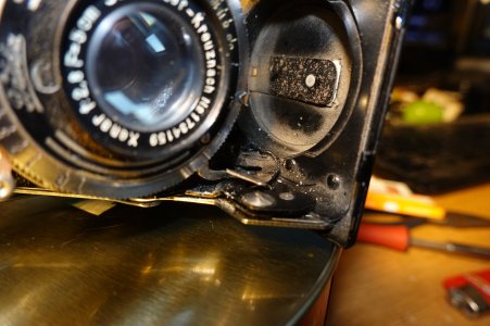

Besides B and T the shutter button is sadly broken. when i got the camera the lever the goes from the button on top of the camera to the shutter release button on the front of the camera was jammed in front of that release lever. No idea how long it has been jammed, but probably long enough to cause one of the two bolts that hold the shutter lever broke off. The broken off bolt including the torsion spring was still in the camera, i might be able to repair that part in the future. For now the camera will not close without force, so it stays open.
I tried disassabling the camera yesterday but one of the tiny screws on the top plate did not want to come loose (even after letting it soak with some oil).
Not really sure how to remove the door to get to the shutter lever assembly yet. Did anybody here ever deal with one of these Super Baldinas?
