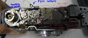

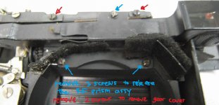

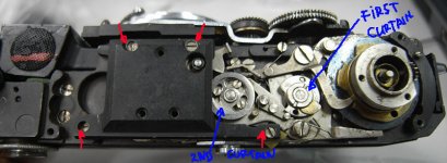

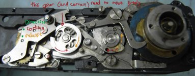

Attached are some pictures for your viewing pleasure... Feedback Please!

Hi Marcoiiic- on the iia (and likely the iia), there is a large flat screw on where cam fork attached to the bottom of the top body (where the film cannister is loaded). Is that used to adjust spring tension? Can that help with low speed problems?
The screw you mention (if I understood you correctly) gives you direct access (without separating the shutter assembly from the rear casting) to the screw tensioning the shutter spring tension. Main problem with doing it this way is that the tension can only be increased. Did ZI provide this as a short cut to fixing the shading shutter at 1250? or for a last minute tension increase adjustment?
Regarding slow speed adjustment, there should be a way to vary the amount of escapement engagement with the second curtain that I have not yet found....

By request from largedrink here's my write-up on Contax IIIa top cover dissasembly. I posted this previously on a repair group.
Contax IIIa camera top removal.
The IIIa top is much harder to remove than the IIa. But not impossible at all.
The procedure can be divided in the following sections:
0. Prepare your mind
1. Remove rewind assembly
2. Remove wind assembly
3. Remove camera top plate
4. Remove meter assembly as a module
DETAIL
0. Prepare your mind: The Contax IIIa was the ultimate evolution of the first professional rangefinder ever, the Contax, This machine was extremely expensive in its day and had the best RF lenses of its day bar none (lol wetzlar). Now it's over 70 years old and thus you will treat it with respect, overwhelming devotion, tender gentleness and loving, geriatric care.
1. Rewind assembly: Remove camera back, unscrew the part that engages the film cartridge (one flathead screw). Remove carefully and take note of where everything is placed. Rewind post can now be pulled out.
Remove film speeds dial, three screws. Everything will come out now, including the base dial with the speed values. Note: for reassembly, you need to make sure the meter coupling lever engages the cam at the underside of the base dial.
2. Wind assembly: Identical to IIa, easy to remove, just remove three screws around wind knob, remove film counter, shutter button, spring, washers (there are also TINY washers under the shutter button). Remove three screws to remove inner wind disc and spring below. Remove shutter speed dial.
3. Camera top plate: Remove camera top screws in plain sight at left and right side (4 in total)
Remove meter top cover plate, 4 tiny screws. Pull it up gently.
Remove meter flap hinge, two screws, be careful. Remove hinge (with flap). If hinge can't be easily removed, loosen accesory shoe screws (4) and windshield screws (3, with locking agent on)
Remove camera top by pulling up gently.
4. Meter assembly
See picture, remove screws 76 and 149. Then, unscrew screw 66320 slowly while slightly pulling the whole module up. Screw 66320 can't be pulled out(removed), and doesn't need to be removed.
DONE, now you have access to the slow speeds mechanism, curtain cams, and you can proceed now identically to the Contax IIa
REMEMBER the maxim of camera repair: "Never force anything!"
