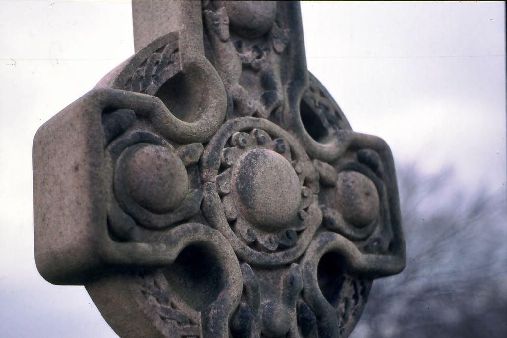

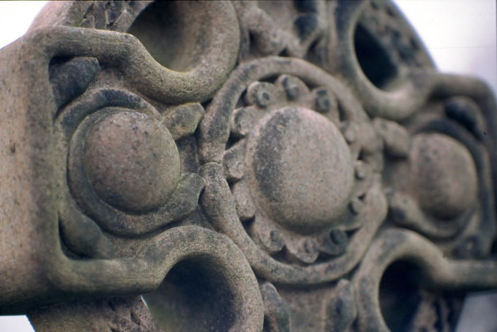

I think the close focus on my J8 and new (to me) J9 seem OK :)
J8
J9
Both taken at f/2 focussing as close as the lens/rf allowed, on expired Fuji Sensia100 (handheld so not a scientific test, but lets me know I'm in the ballpark)
The left-hand outer edge of the largest central ring (if that makes sense)
(actual POF depends on whether I was swaying in the cold wind or not at the time :) )
Spot on. You are lucky :) These are great lenses when they work as father Zeiss intended :)

closest focus + widest aperture = the hardest and true test for any lens.
Cheers,
Ruben
For clinching evidence, you could do shots from a tripod or on a table top. A lucky man if you got a good J-9. They are reputed to be very difficult to reassemble correctly.
