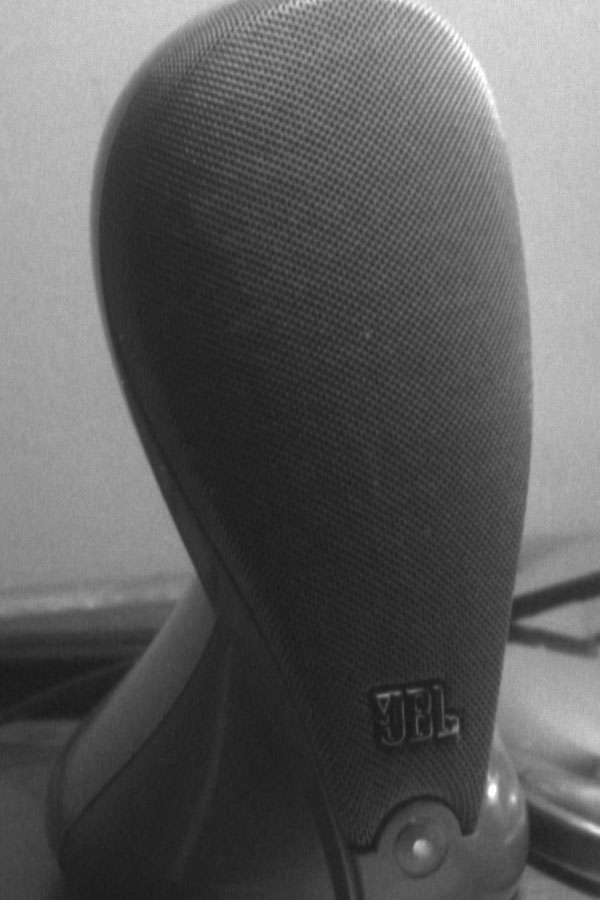

I have a curious question... what gives the film this look? Is it a low contrast developer or is it just printing with very low number contrast filters?
It's XP2 Super scanned with Canon 4400f. Xp2 is low contrast when shot @ 50 or 100 ASA. These images are with whole recorded dynamic range. You can made it more contrasty in PS.
