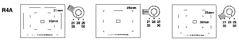

Hi Peter,
Can you expand on this, please? I'm very interested in the R4A to use with my existing CV 15/25/35 LTM lenses but I'm also considering biting the bullet and buying into the Leica system with a 0.58 M7.

hi Chris! Two reasons really (at least in my tiny mind). (1) Parallax correction in the VF for lenses to 21mm. Anything down to that focal length and you don't need a separate finder. If you've ever broken the shoe of a CV finder you'll know how great that is. Now I can use my Leica 24mm lens just that little bit quicker. 🙂 (2) A 28mm frameline on it's own in the VF. This camera is made for my Konica 28! Lots of room round the frameline too. I'll try to scan & post the frameline map from the manual so you can see the three VF layouts. So far I have not tried a 35mm or 50mm on the camera but hope to soon. I think the major advance is the parallax correction for the super-wides. That is just a real nifty innovation that I think makes the camera more practical than a 0.58 M7. If you use a 21 or 24/25 lens the R4 should receive some serious consideration.

OK Chris, a quick scan from the manual will give you a sense of how the framelines look in the R4A viewfinder.

Very helpful information, Peter. Thank you. I am giving the R4A some serious thought. The VF looks well-suited to a glasses-wearer like me.
