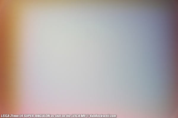

I just purchased a Leica M9--it's in the mail, working its way to me. I want to get also a 21mm lens for occasional use. I'm thinking an inexpensive one would be fine. So I want to believe that the Voigtlander 21mm f/4 lens will work with the M9. I read the positive comments here, but I'm concerned by Ken Rockwell's multiple warnings on his site.
He claims that the M9 will have problems with any of the 21mm lenses except for the newer Leica and Zeiss f/2.8 lenses--except that they block the viewfinder and don't use his preferred lens filter. He's obsessed with lens filters. I wonder if there's a psychological term for that: filtered fixation? Sorry. Got sidetracked.
In his review of the Leica 21mm Super-angulon f/4 lens, if you look for the section called, LEICA M9: Insufficient, you'll see a photo he took of a white wall using that lens with an M9. It shows the extreme edges of the image to be discolored. That concerns me. I saw the photos others posted here, but they're not unobstructed images of a white wall.
All of Rockwell's reviews of the 21mm lenses, in which he says the Leica M9 camera has problems with them, were written a few years ago before several updates to the camera firmware. So maybe he's wrong at this point. Maybe the M9 can handle these lenses.

That's classic "italian flag syndrome", Russell. It seems to be caused by the steep angle of light hitting the sensor. This is affected by the optical construction of the lens. Lenses built to minimize this angle can avoid this problem. It seems worst on older smaller wide lens designs like the f/3.4 Super Angulon, and the f/4.5 C-Biogon 21mm, and avoided with retrofocus wides from SLRs for instance. I believe the latest wide lenses (18, 21, 24mm) from Leica have been made to address this issue too.
