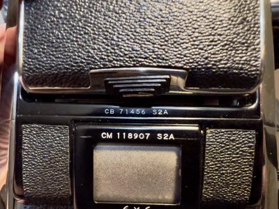

Really nice - an S2? I seem to recall that the S2’s had the ‘wings’ on the strap lugs, and I think the S2’s film advance knob was more conical in shape (as I think yours appears, hmm maybe not!), plus if it’s ‘flat’ behind the crank arm (without a round screw in the middle) then it’s an S2. Serial number would tell us for sure (above 150,000 Is supposed to be S2a).Discovering I have a thing for cameras that let you know an event has happened when tripping the shutter....

Thanks, it is a S2A.Really nice - an S2? I seem to recall that the S2’s had the ‘wings’ on the strap lugs, and I think the S2’s film advance knob was more conical in shape (as I think yours appears, hmm maybe not!), plus if it’s ‘flat’ behind the crank arm (without a round screw in the middle) then it’s an S2. Serial number would tell us for sure (above 150,000 Is supposed to be S2a).

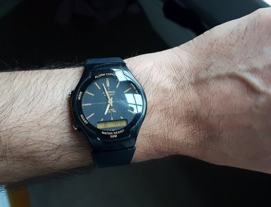

I received that model watch or something very similar to it as a college graduation present over 40 years ago. I loved it and it never failed me. However, because I sit at a desk and pound on computer keys all day long now, I wore out the watch band, several times. I literally wore the clasp off the bands.
I couldn't find a direct replacement band, so I retired it.
I miss it, but I can't kill my $ 40.00 Casios! 😉

Ah okay thanks for clearing that up. Gorgeous camera, love that 40mm lens (wish I had one!).Thanks, it is a S2A.
The first few years ('69-'72) of the S2A had the wings and their serial numbers identified them as S2A.
In 1973 they changed the lugs to not have the wings and they removed the S2A from the serial number starting at body #150037. That wasn't the start of S2A production though.

Mine is an S2 (CB 69xxx), so I'm assuming to be at the tail end of their production based on your serial number.
