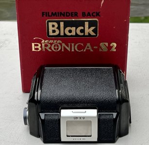

Blaming Retro-Grouch for this one. Figured black would be a good reminder for me to not shoot square. What is the S F setting all about where 120 or 220 is set on the regular backs? Dummy roll with it at the S position (where 220 is on the regular back) was 16 frames.

Glad to take credit! 😉
The 645 back doesn't have a 120/220 setting. From the manual:
"After taking last (12 th or 24 th) exposure, wind forward until indicator in film counter window does not move. (On the Model-E [16/32 exposure back] after the last (16 th) exposure on the 120 film is shot set pointer to ''F'' by pushing the free lever to right. Film winder will become free and the film can be quickly wound up on take-up spool)." The Model-E is what Bronica calls the 645 back.
In other words, keep your eye on the frame counter and don't make exposure #17, unless you're shooting 220, which is highly unlikely! I found this design quirk to be very strange, as well. Or charming, depending on how you want to look at it...
